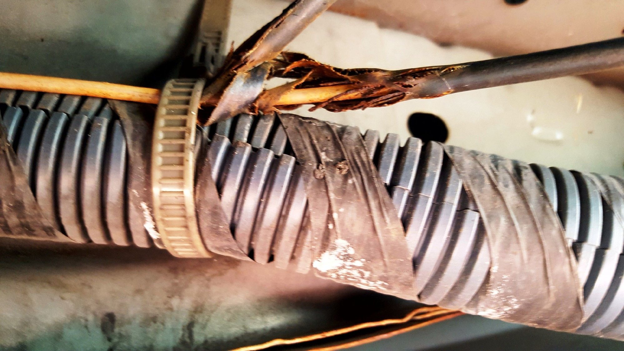

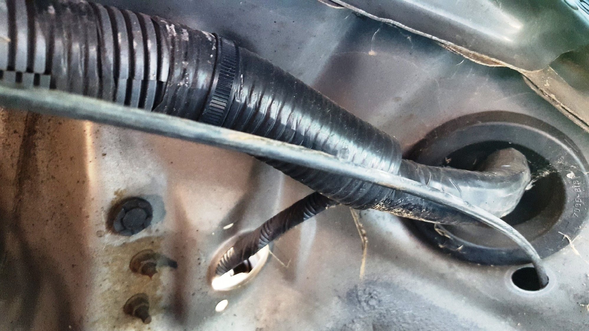

Removed the inner plastic wheel well liner and like JS said, it had something preventing it from passing!
Nylon Ties to the big wiring harness tucked way up high! For any of you poor slobs that might be forced to do this because of AGE! (The car, NOT you!) LOL Got to get behind the plastic barrier and help it through or cut both the nylon ties and replace appropriately!

WTF happened to that cable?!
All I can think is age and exposure. 227K and never garaged. The area where the fraying started was where it travels along and then passes by the radiator and then along back of the upper radiator support.
Vibrations and wind speed causing enough friction to make the brittle wrap fray?
Trying to pull it through finished the job to shreds!
Thanks again for getting me right to the Log Jam! LOL
Another repair on my never ending, unknown bucket list!

I understand now. At least it was (relatively) easy.
