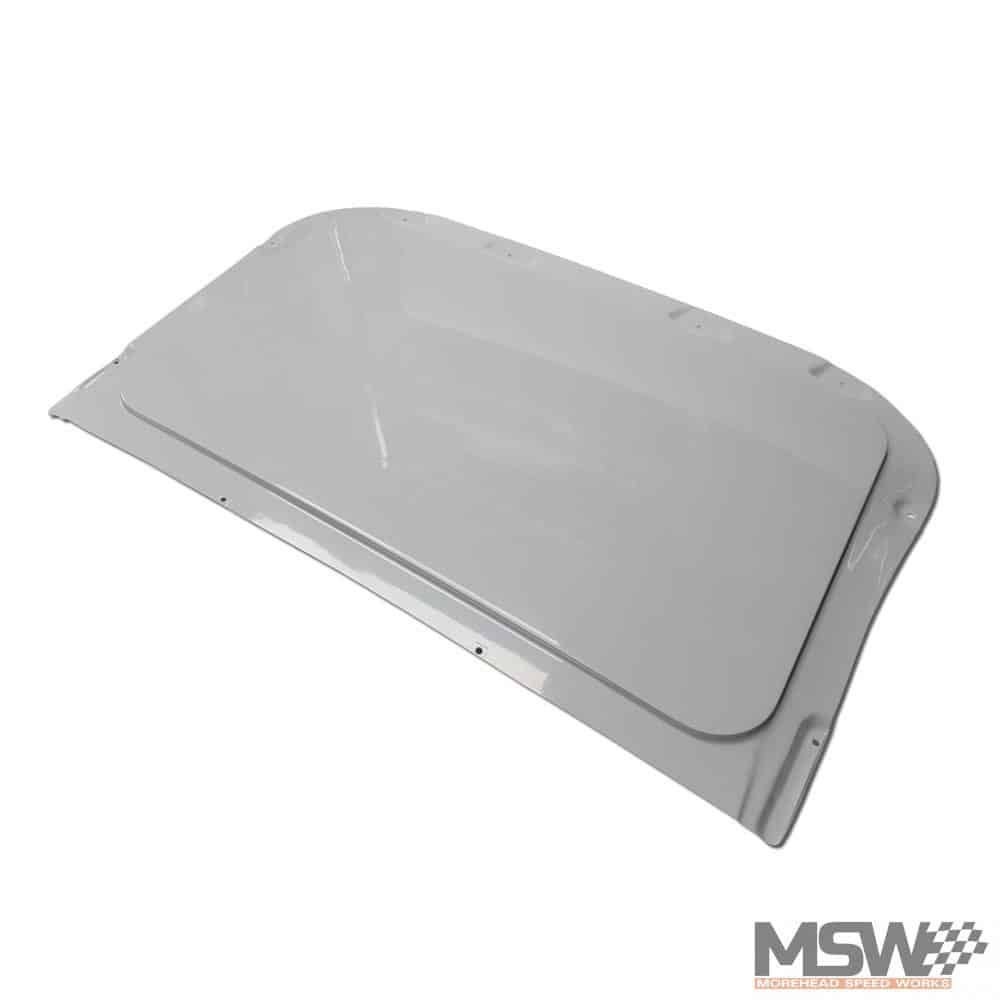

Hi guys. So, my 98 sunroof doesn't go up evenly anymore. I managed to get it as close as possible, but I'm getting worried that it'll eventually start to leak. Sunroof drains are already causing the quarter panels to rust as well, and quite honestly I'm tired of it. I was wondering if anybody has managed to make a kit to completely delete the sunroof. I would prefer if it would bolt up to the factory mounting locations, rather than having to drill into my roof but if thats my only option it is what it is. Pic attached for an example, from an e46 delete kit
Old May 3, 2023 | 12:24 PM
No such kit exists, you'd have to make your own. I suggest you clear out any clogged sunroof drains.

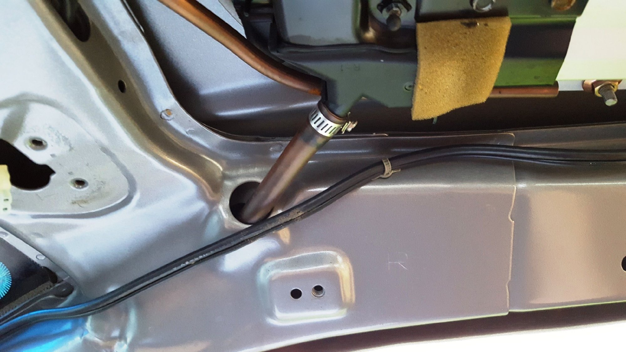

Sometimes the drain tubes that takes the water collected in the "Gutter" system, pulls off the attachment area. So instead of the water exiting via plastic hoses to the bottom of the car to the ground, it comes into the car and leaves the carpet like a puddle. I used hose clamps to make nine never did that again.
