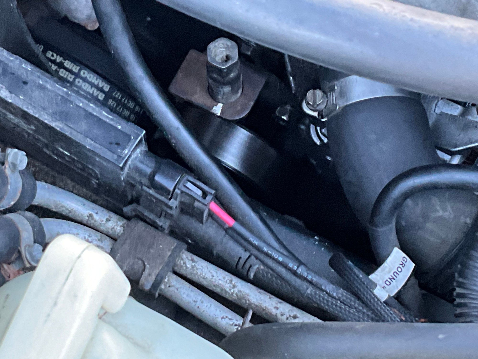

Your tensioner does not look right in the pic you posted. Something could’ve happened when you were trying to tension the belt, maybe the locknut was not loose enough to allow for adjustment.
you said you took the tensioner apart and found a spacer not in the right position, so something is definitely off with your tensioner. Another thing I noticed from your pic is how “shiny” the adjuster is and it looks out of position.
I would add a +1 to the comment above and advise that you replace the tensioner

When you put the belt on, does it just slip into position without any resistance or do you have to push into position under the tensioner pulley?
Just from that first pic you posted, it looks like the adjuster is turned in way too much. Did you try to loosen the adjuster? You should also check the threads on the adjuster for damage/stripped etc.

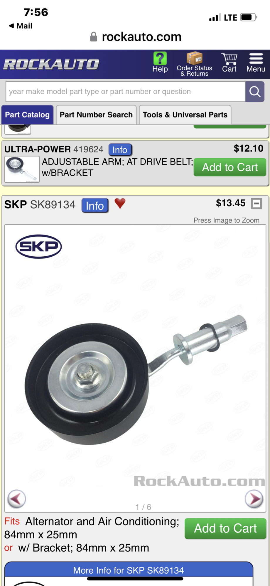

I ordered a new pulley and it should arrive sometime tomorrow. Once the new pulley arrives I’ll take pics during the various stages of installation and, if possible, will shoot video of the tightening process
Old Oct 17, 2023 | 06:01 AM
islanddean's Avatar
Joined: Jun 2014
Posts: 78
This is the assembly I’ve purchased. Can someone tell me what that small ring is for and where it’s supposed to go and what function it performs? I’m almost certain that small ring is not on the idler that’s currently on my car.
insert frustrated emoji face here
Old Oct 17, 2023 | 06:57 AM
dsonnylal's Avatar
Joined: Oct 2011
Posts: 122
From: Bergen County, NJ
From the looks of it, I think once you slip the new pulley assembly up thru the bracket, that o ring goes on the underside between the tensioner adjuster and bracket. But maybe another member can confirm as I have never had to replace the tensioner.
