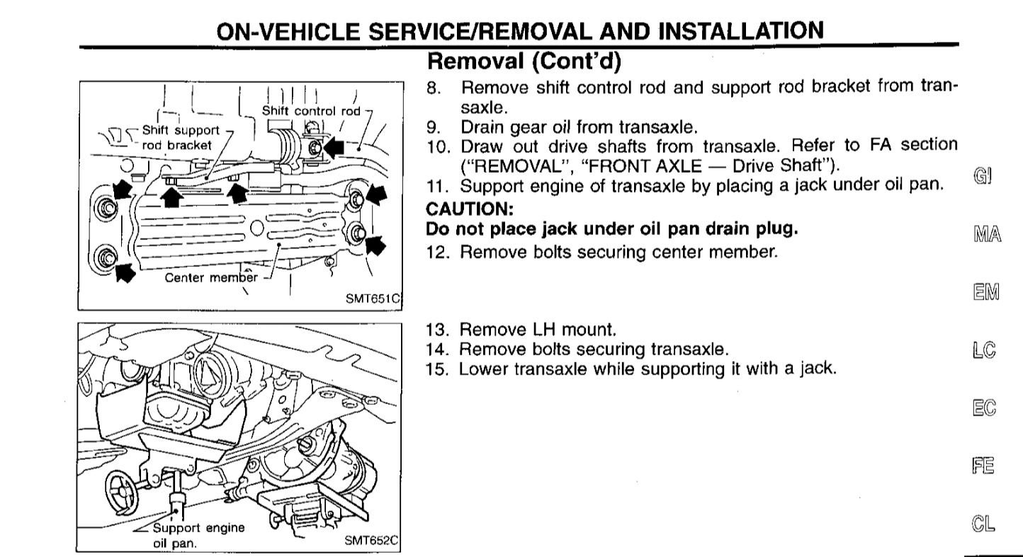

Here’s what the FSM says related supporting the engine for the purpose of removal of a manual transmission …

No, the write up about removing rack and pinion doesn't include removing the transmission. What @@Turbobink posted looks like it can support the engine by putting support under the oil pan.

The 2 remaining mounts will hold the engine & trans in place. For peace of mind you can use an engine support bar from above or put a jack stand and wood block where the cross member was.
So you're saying if I remove the support bar / cross member, the engine won't fall because the remaining mounts will hold it in place, and I can support the engine with a jack after I removed the support bar? I like the idea of using an engine support bar from above because it clears up space underneath the vehicle.
