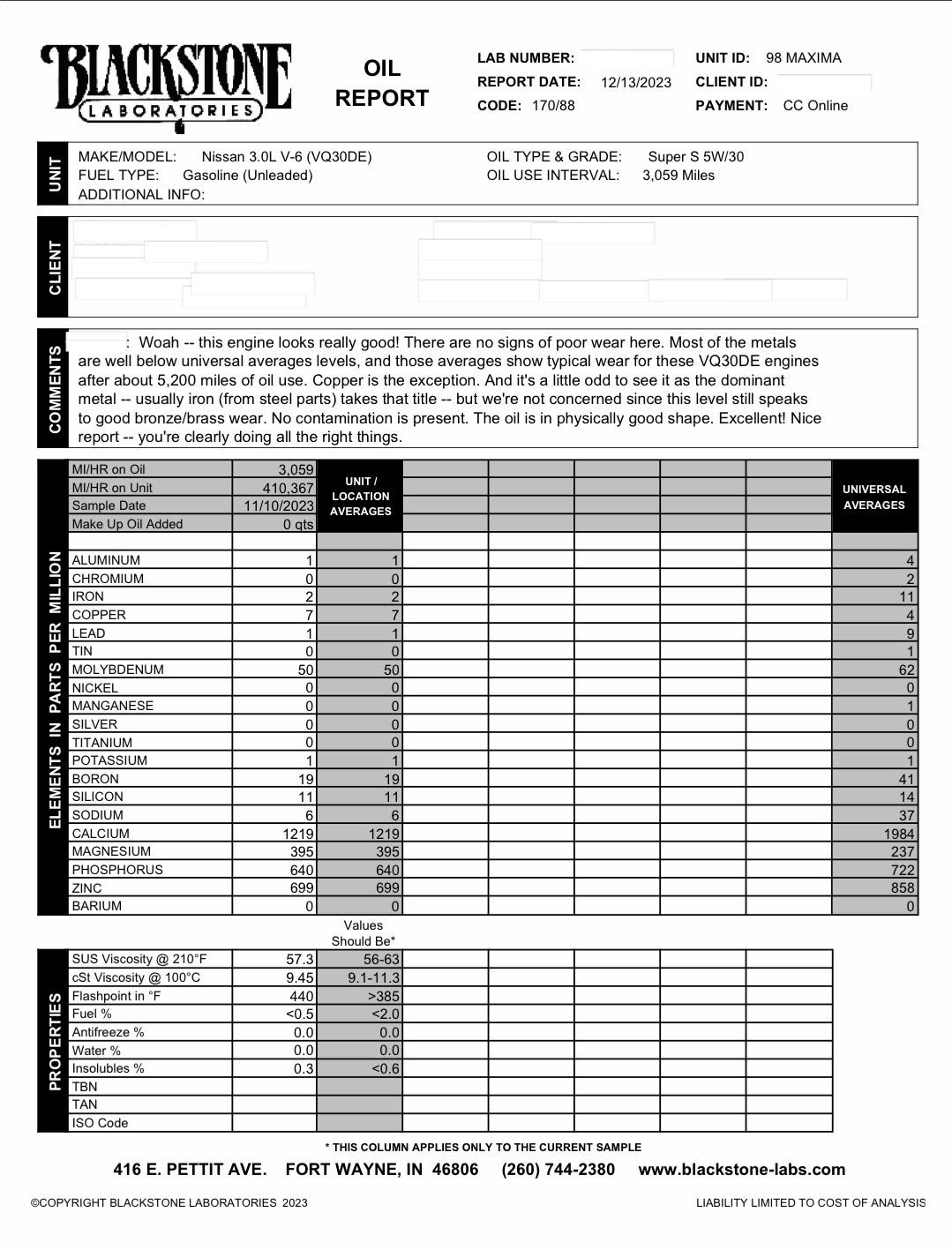

Anyone ever done an oil analysis on there Maxima or other car? Just got this report back and I thought it was really cool how u can tell how your engine is running after all these years.

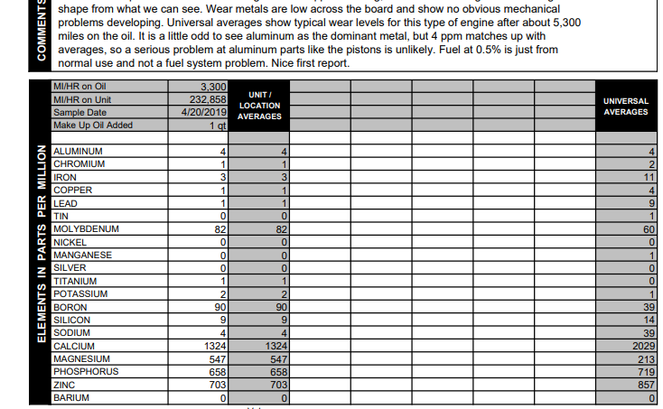

Yeah, here are my results from a few years ago. Comparing numbers, it looks like your engine is in much better condition than mine. I have gone through 3 odometers and have lost track of the mileage on my car, but I estimate I was around 200-215,000 miles when I sent my oil in.

My father took really good care of it before he passed it on to me. Everything that was fixed on the car was factory parts and any problem it had was fixed the next day. but i always change the oil every 3,000 miles conventional oil, he changed it about every 5,000.
