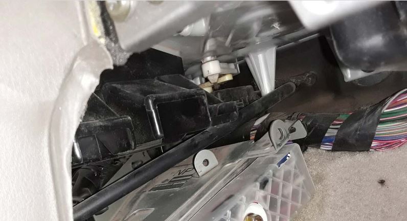

Vladimir_K's Avatar
Joined: Nov 2021
Posts: 10
You can see position of the actuator arm from passenger side for min and max temperature set point. It should change. If not than a problem is actuator, or actuator door. In case if it is moved than check a heat exchanger ( no coolant circulation - check temp of hoses )
