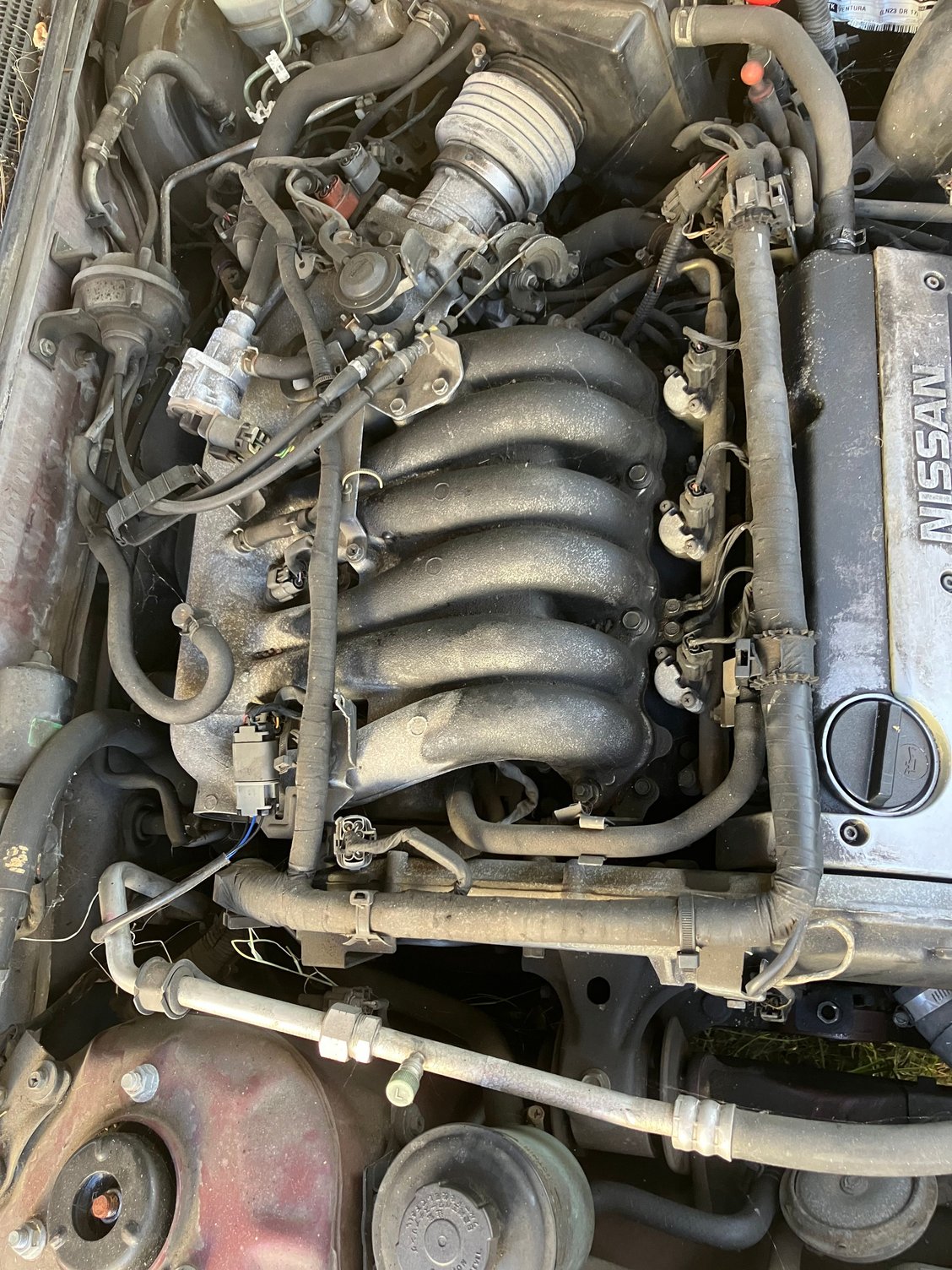

It ran great before the work? It doesn't misfire right now? Any warning lights on? Could be a bad injector.
Can you post pictures of the engine? Are all the ignition coils and the opposite end of the harness plugged in? Vacuum and emissions hoses connected correctly?

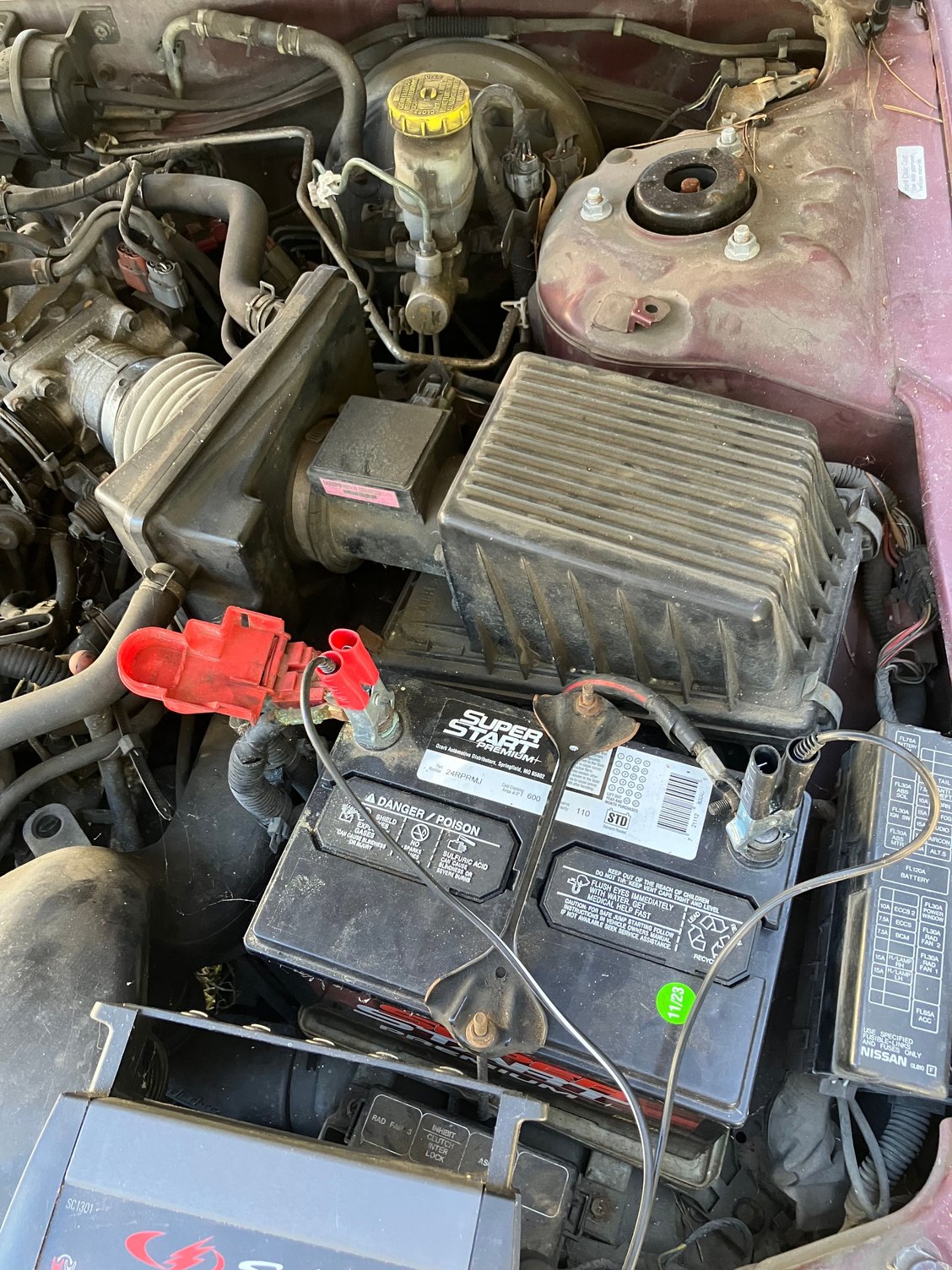

I’m charging the battery and will do my best to answer your other questions after I start it again.

The smoking and fuel in the exhaust is due to failing/failed fuel injectors.
Either have yours rebuilt or purchase new or rebuilt ones.
