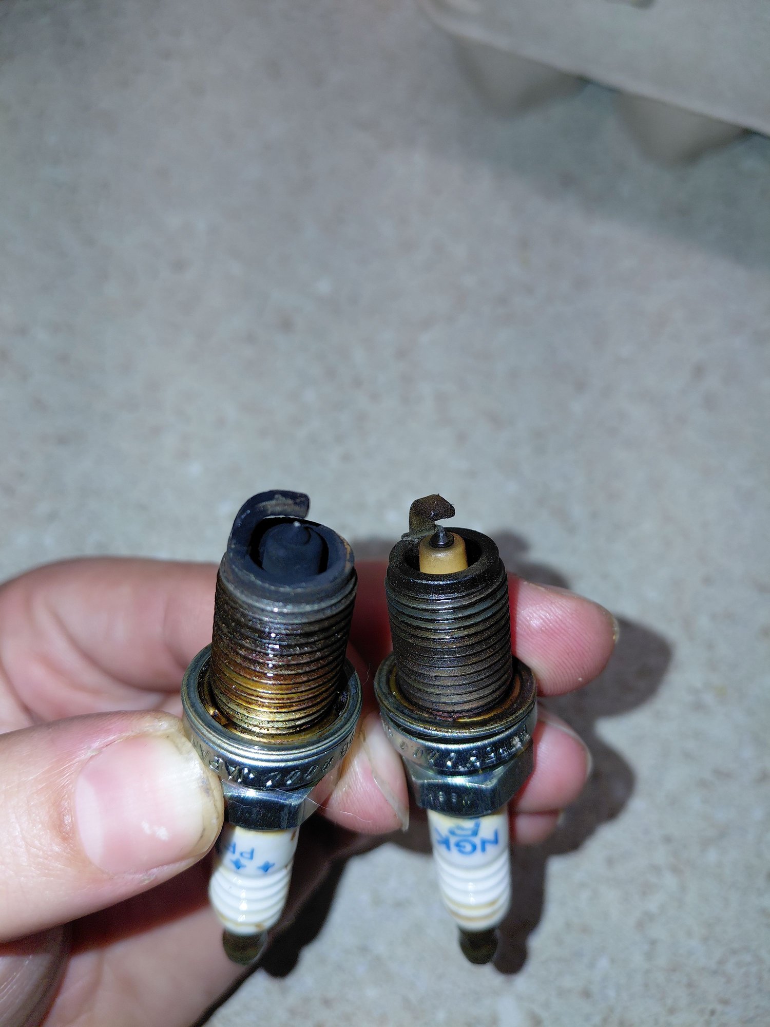

Guys so I was on my way back on from the mountains and during the drive I noticed lack of power and studdering especially when I let off of the gas pedal. I thought the hills have done something to my transmission. So I pulled over at a rest stop when I eventually got to one after 30-40 minutes of driving. I pulled into a parking space I realized it is the engine. The check engine light was not on. Then as I left the rest stop after letting it cool down hoping maybe the hill over heated something the check engine light came on. And as I am going up the hills it would even flash.
Hoping it was a coil pack or boot but I have to get home I am 3 hours away from home. I drove it home and in the morning I drove to autozone to get the check engine light tested it came back as a po300. I took it home and quickly identified which cylinder is not firing. I swapped a coil pack from another cylinder next to it hoping I can move the problem if it is a coil pack but it did not it still stayed the same cylinder. Now I'm freaking out that its something more serious. I replaced the spark plug with a new one and that didn't do anything. Also will note while I am testing for spark by slowly pulling out the coil pack I quick flame ejected out of the hole... Hopefully this is not a head gasket issue but I will say this the coolant and oil is where it should be and the oil is not milky white.
What is wrong with my cylinder. I got a test kit for compression and I took all the spark plugs out and removed the fuel pump fuse then I tested each cylinder... Nothing seems to stand out from each of the cylinders. This cylinder is getting everything it needs but won't fire? And it is very rich as the spark plug from that cylinder was soaked with fuel and black I will post a photo below. Also the engine rattles with this missfire.
(1) Photo attached below:
Left spark plug is the one in the cylinder that is not firing. Right spark plug is what the other 5 cylinders look like.

It’s your fuel injector …

The cylinder is getting fuel. The spark plug is soaked in it and also fire came out of that hole.
Old Aug 31, 2025 | 01:30 PM
Gonna have to agree with Turbobink, it's your fuel injector. It's malfunctioning.
With any luck, the bad injector is on cylinder 2, 4 or 6. Easy replacement.
Ultimately though, I'd replace them all due to their age.

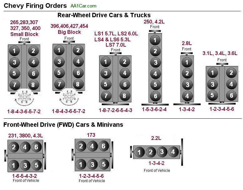

Old Sep 1, 2025 | 07:28 PM
Originally Posted by js8
I believe mine is on cylinder number 2 and it seems the whole air intake system needs to be removed.
Cylinders 1, 3 and 5 are under the manifold.
Oops I used this one to see which one it was. But I like your image better. So it's cylinder 1 oh well. But yeah I have to take all that stuff off. But I found a shop that will look at it for free tomorrow. I noticed some people saying aftermarket is ok in here and your saying use a set of OEM ones I don't have an extra set and I remember fuel injectors can be a pain to remove. I don't have $800 laying around for fuel injectors.... No way. The main thing is I hope my engine isn't done for.
I also noticed it's a Chevy diagram.
Removing and installing fuel injectors is actually quit easy and takes seconds to do, if done properly. Getting to the injectors under the manifold is a different story. Being your first time, I'd set aside about 6 hours to do the entire job. Once you're familiar with the car, it can be done in 2 hours.
On a side note, that Chevy diagram is the FIRING ORDER of the injectors. The firing order doesn't necessarily coincide with the cylinder locations.....regardless, the diagram is useless for our beloved Maximas.
