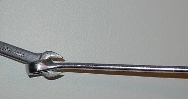

a trick that works 4 me is like stated above use a longer wrench for more torque, but when thats not enough u can use another box end wrench (on the opposite end of the wrench ur using to remove the sensor) which basically doubles the torque and easily breaks it loose, just be careful not to let it slip since its not stable as a single wrench.

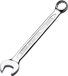

any/all special o2 wrenches are junk
cut the wire and use two normal, high quality wrenches, use the round part
lock them together and pull as hard as you can
i tried everything before this method and this was the only way, it was on there with like 300lb/ft torque, i thought i would rip the entire exhaust out
oh yeah, and i tried the impact socket w socket wrench method, broke two good ones, 3/8 & 1/2in both blew to pieces

I always cut the wires off and use a 6 point impact socket.
a few months ago I had to change one of a G37 coupe and I actually cut the main part of the sensor off leaving the hex so a short socket would fit. that I used the open end of a wrench to tighten it down.. they don't have to be put on super tight.
