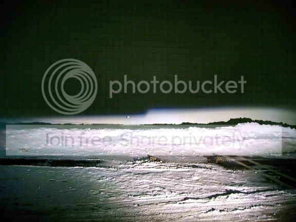

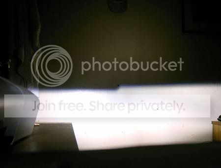

another update for those interested ,here are are just a couple of the many pics i took, while adjusting the projector,using different #s of washers between the lense cutoffshield and reflector, and adjusting the location of the cutoff shield between thaose washer. I found a setup i am comfortable w/ and am going to (finaly ) re-install the projector, i will try and update the writeup soon.
this was taken in my room w/ the projector @ 10'
no washers........................................... .................................................. ...... 5 washers

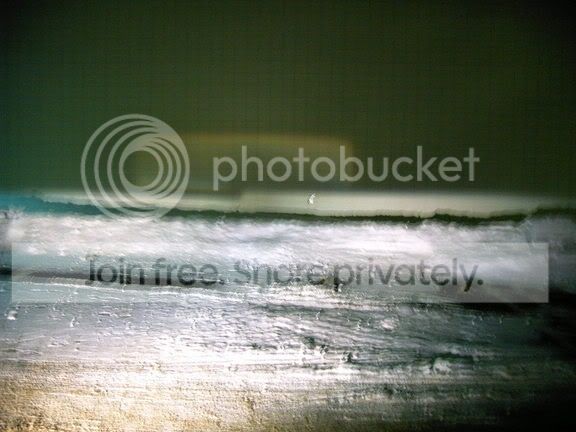

these were taken in a very cold parking lot, the unmodified projector is still in the housing on the car while the other is sitting atop the housing, secured & aimed by wrapping it in a towel and closing the hood on it, both headlights were on, to take a picture of one beam i stood in front of and blocked the other, the difference is more apparent in person but notice that in the unmodified pic, it is darker in the center
unmodified .................................................. .................................................. .......................modified

unmodified .................................................. ....................................modified...... .................................................. ...both
the camera didnt pic up the true distance these projected, but what it did pic up shows a difference.

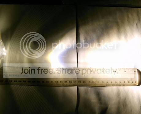

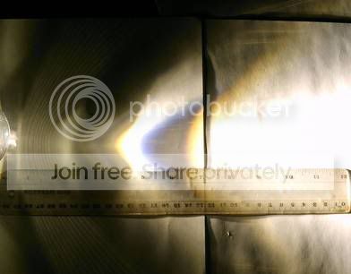

And 1 final set of picture that i found interesting, and worth posting.
these were taken from above, notice in the unmodified projector the first intensity has a wider angle than the modified projector and tends to flare of towards the edges, the second pattern of intensity is initialy yellow on the unmodified projector also has a wider angle than the modified projector, this may help explain the increase in down the road intensity
