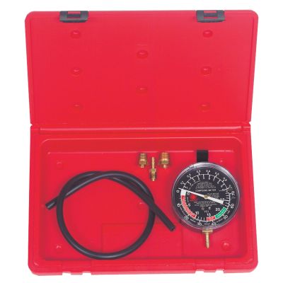

the best way to tell an exhaust restriction short of unbolting at the ex. manifold is with a vacuum gauge.
Is this gauge really that helpful in terms of troubleshooting exhaust issues?
absolutely, you can tell many things about the way a car is running with a vacuum gauge...
basically, a no load, raised RPM (2500ish) will provide more flow than the cat can deal with... if the engine cant push the gas out, it cant bring a gas in, which causes a decrease in vacuum.
normally, holding at 2500 would give 18-22" or so... maybe a little lower. a restricted exhaust that figure will drop slowly, usually down to below 10", depending on how bad it is...

no, this is what im talking about:
