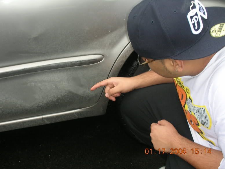

Well i live around philadelphia, and this past saturday night we had very heavy snow. I came back from work and parked my perfect max behind my three other cars because there was no other parking spaces left. (I live in a town house). In the morning i wake up and look outside my window and i see a car backed up into my maxima. I run downstairs and outside and the guy explained to me what happened.
He was trying to back out of his parking spot, but he was getting no traction.....so he floored his car and suddenly got traction and he braked immediately. There was still bout 3' inches of snow, so his car slipped and his trunk ran right into my rear driver side door.
I just wanted to share this with all the fellow .org members and see what you guys thought. I got a estimate on the repair and it came out to be $1,242.00
And yeah the person who hit my car is paying for everything. He didnt want to go through insurance but i still have his info. So for 1200 bucks, dont you guys think i could get a new door? any advise or thoughts are welcome.

Wow, looks like you would need a new door. That would be around $1200. lol J/K that would be that much if you'll buy it from the stealer ofcourse. Well try to look for the door at some autopart.com place do some research and I'm pretty sure you can find one for around $400. It's might not going to be new, it could be used but in good condition.

Sorry about what happened, as stated above collect that money quick and find a used good condition door itll be much cheaper than a new one
lucky he only caught the door and theres no quater damage, those repairs get expensive. but as everyone else stated, try and find a used door and pocket the rest of the cash

Funny thing is, although everyone says get a new door I will risk getting punched at by saying that one would have to see the door up close to find out
A new door is nice and better business for a shop that can milk him for hitting you, but not always necessary.. in this case it looks like just the skin anyways, not the entire shell, but again - you gotta see it in person to find that part out (and I think I'm too far for an opinion lol).

Sorry to see that, but this door would not be that hard to fix, some guy might tell you to change the door because it's easier to do but defenitely this door is repairable, the total labor would probably not exceed 8-10 hours.

With that type of damage i'm sure what they are gonna do is change the skin.grind around the edges peel off the old shell then bend the new one around the edges weld a couple of spots and it should look perfect when they are done no sweat, should be alot cheaper than getting a new door too.See if you can work something out with the shop (money in your pocket) If the guy that did it is gonna pay that first estimate that is.

I cleaned my car, detailed it. took some more pics. Hope these are more clear.
cant really see it from this far.....

here are some pics the day after it got hit......and imma throw in some random pics of my car, see what you guys think. enjoy and thanks again.
