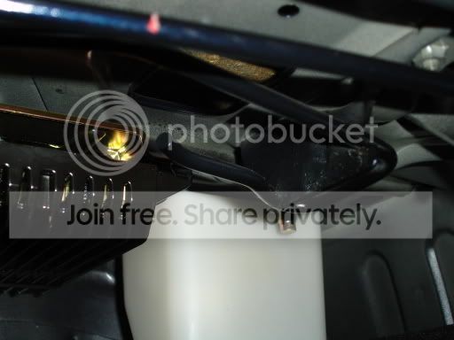

Old Jul 18, 2006 | 07:31 PM
BewstAdd1ct's Avatar
Joined: Dec 2004
Posts: 1,587
From: Lakeland, FL
here, this might help

Old Jul 20, 2006 | 03:31 PM
Joined: Dec 2004
Posts: 1,587
From: Lakeland, FL
Originally Posted by BewstAdd1ct
use a deep socket with an extension attached to it.
the socket goes over the end of the bar and you can apply tension to it.
remove the bar with the loose end from the groove, at this point, the bar might snap out of place, so be careful.
the trunk also might fall, or drop slowly.
also note, ive done this on several cars, but not a maxima yet, so im basing this on non-specific experience.
good luck
