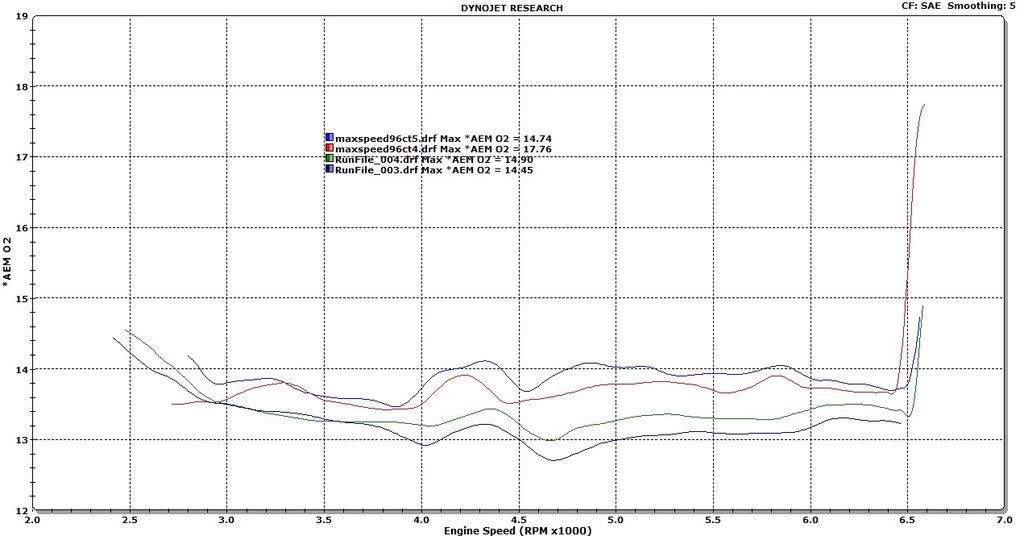

Yeah it's pretty shady that vista
Here's the AFR.
Old Apr 4, 2007 | 10:03 PM
  #67
machinehead131's Avatar
Joined: May 2006
Posts: 772
Are these numbers low?
Old Apr 4, 2007 | 10:19 PM
  #68
NmexMAX's Avatar
dot dot dot ...
Posts: 34,576
From: Santa Fe, NM
There's definitely room for improvement.

Can you post a comparison of my number to yours, i wanna see were the peak differance is.
Old Apr 5, 2007 | 06:34 AM
  #70
NmexMAX's Avatar
dot dot dot ...
Posts: 34,576
From: Santa Fe, NM
I'll post it later. Don't have my runfiles here.. . Looks like they're nearly identical, but I then show more power from 5100 - 5700, and my peak at the time, (233) as @ 5600.
