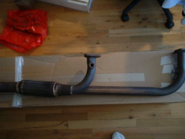

I'm trying to determine if this Y pipe is is a '95-'98 or a '99-'01 Y pipe. I think it is a '95-'98 because all of the '99-'01s that I have seen have a straight pipe to the Y connector from the from manifold. (I pulled some of my data from the pictures on Cattman's sit) Am I incorrect?

Looks like a 95-98 FED spec to me, it could fit the 00-01 also , not sure.
99 & up CA spec would keep the bank 1 precat, this one does not.

That is a 95-98 FED spec. The one you're looking for will look like this: 00-01 Y-pipe and that's depending on if you're in CA or not.

thats a fed spec ypipe for 4th gen
