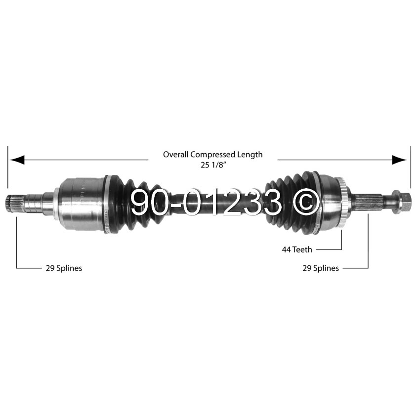

so i decided to replace my control arm and i have done a great job installing it, while i was at it, i noticed my passenger side axle is broken so, i took out the 3-12 mm bolts holding the mid shaft and the cv axle, When i purchased axles for my car i only purchased the actual axles without the mid shaft like in the picture below,
Can someone tell me how can i separate the mid shaft from the worn axle, i have tried all possible methods but i just couldnt separate them!
This is what i have now but the worn axle is attached to the shaft as in the picture below
The axle bought is a NAPA brand and looks similiar to this
Any help is greatly appreciated.

if using a large pry bar didn't work. go rent a slidehammer from Autozone to pull it out.

Turns out the axle i bough was the wrong one its suppose to come pressed right with the mid shaft
