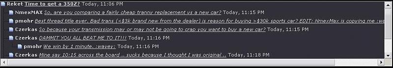

Originally Posted by Czerkas
Mine say 10:15 across the board .. sucks because I thought I was original ..
I see you as a minute later
That's vBulletin for you...
