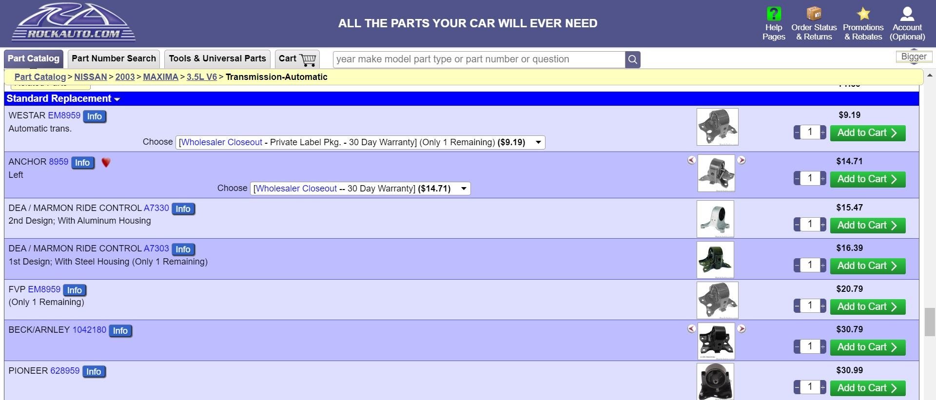

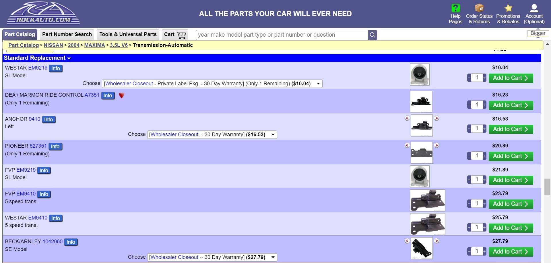

i would recommend comparing upper tranny mounts as well as attachment points when it comes to swapping an auto from a different generation maxima.
Old Aug 29, 2024 | 07:50 PM
uptownsamcv's Avatar
Joined: Dec 2012
Posts: 1,345
From: Kissimmee FL
I looked up 5th and 6th gen auto mounts on Rockauto. I believe the first 3 years of the 6th gen used a 5 speed auto than they went to CVT after that..
5th gen auto
6th gen 5 speed auto
