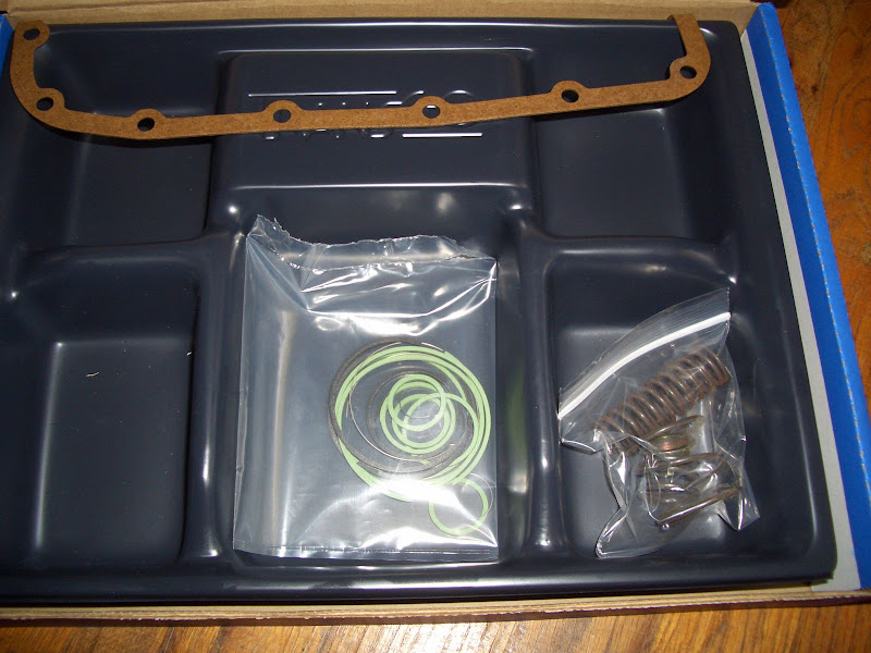

Originally Posted by skidz88
Also, am I gonna have to supply the shop with a new tranny oil pan gasket for when the guy bolts it back up?
There is one in the kit but Im not sure if you want to use it. Its kind of folded around the inside of the box to make it fit.
Old Mar 25, 2009 | 04:54 AM
  #125
skidz88's Avatar
Joined: Jun 2007
Posts: 283
From: Toronto, Canada
My kit never came with one. I got the regular kit, not the HD2. Guess I'll go buy one.
the one in the kit is fine, but you can still use your old one if it isn't damaged.
I have built these, so if anyone has any questions about the kit or install, I'll be happy to answer. I'm currently working on a proper review with video, so people who are interested, let me know what you would like to see.

Had this kit installed today along with new shift selenoids. Made a huge difference, no more slip. It is only a bandaid solution though.
Reason why these cars slip is the 3rd gear clutch seals shrink over time and cause a loss of pressure inside the tranny. Increasing line pressure in the VB with the transgo kit is a good way to prolong the life of your tranny, but the damage has been done. And eventually, the problem will resurface again...just might take a year or so before the slip returns. I'm glad to have bought myself some time to source out a 6spd swap at my convenience. Oh, and my info comes from a very well known Nissan master tech up here in Toronto. Many people can vouch for him on torontomaxima.com as well as in the Canadian section of G35driver.com.

Originally Posted by vastmax
The kit includes new seals for you to change out, are these seals not included in the kit?
You can't change those specific seals unless you drop the tranny, it even says so in the instructions that come with the kit. My tech says if you're gonna replace those seals, might as well rebuild the rest of it while it's apart.

Originally Posted by MidN1te
so the cheapest i found the transgo kit was fro like 60 bucks.. i would just need to find someone to do it for me.. lol
please share your source
your tech is correct, the tranny has to be literally completely disassembled to install the seals included with the reprogramming kit. might as well rebuild it while its apart.
