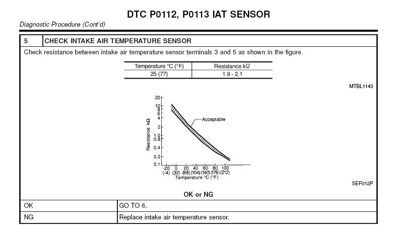

Originally Posted by jeisai
Do you know what the resistance/wattage/etc is on it? I may just go to Radio Shack and pick up an equivalent and see if it'll work.
You need a resistor that has these specs. See attached.
Ok, so 2 questions:
1. You can for sure get these at radio shack?
2. What do we do about the metal wires that run from the sensor to the metal clips on the MAF?

Originally Posted by wyche89
Ok, so 2 questions:
I haven't seen any thermistors at radioshack, and they don't appear to list any on their site.
Just solder it in place, that's what I had to do when we replaced Merlyn's MAF as well. The original MAF had the thermistor soldered in, not clipped.
A resistor won't work, it's just a single resistance all the time. A thermistor changes resistance by temperature, which is what you need (NCT).

BTW the 01 MAF has been in my car for probably a year and a half. The car has 87k so maybe my coils need to be replaced? I would like to get it back
The operating temperatures on that are quite a bit lower than the one in the MAF, and the one I ordered.

Looks exactly like the old one, maybe a tiny bit larger. Installation was the same as the old one. Just went right in.
And I will post updates every few weeks for a couple months so everyone knows whether or not it works. But hey, for less than $25, it ain't a bad deal. And it was only that much because I bought ten!

Too connect this to the other MAF thread, I've been using a honeywell thermistor (p/n 135-202FAG-J01) detailed here: http://forums.maxima.org/5th-generat...ml#post7318741

If the 2.7k one keeps working well it looks like you found a solution for all of us. Keep posting and let us know.
If not and we need the other one we'll need a heck of a group buy.
Just a bump for everyone's info - almost 3 years later and the thermistor I ordered and installed in this thread is still working perfectly. If anyone else has this issue, try the AL03006-1576-101-G1.
