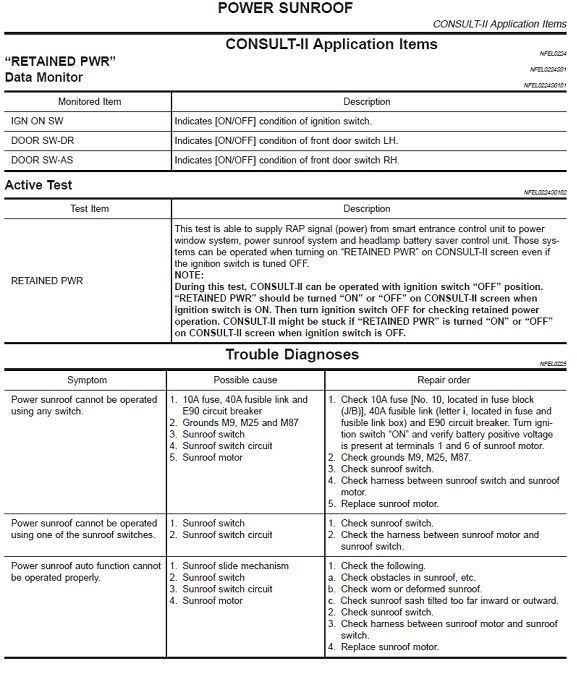

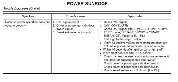

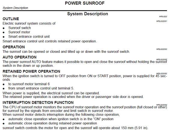

It does sound like you have a fuse/ wiring problem from what I have read in the FSM which you can find here
http://www.boredmder.com/FSM/Nissan/Maxima/
you will want to read the 2000 Maxima .pdf section EL pages 178-181, which I have displayed below,

if you checked all the fuses and it looks ok, start by checking to see if you are getting power and grounds at the connector on the sunroof to test if switch OK.
also do the same for the sunroof motor.
i doubt it would be the harness, so start from there.
motors and switchs do go bad and so do harnesses but most likely it could be motor or/and switch inop
