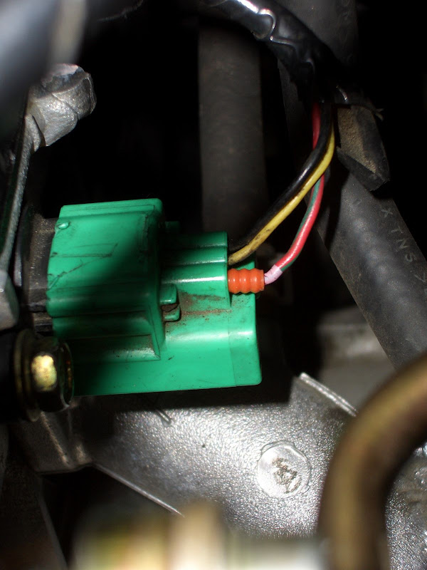

Check the plug for the cam sensor. I was going through similar issues and found out that somehow during my troubleshooting this happened to my plug.

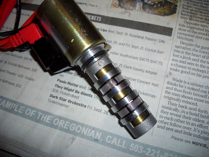

Also you can take that IVT solenoid out and apply 12V to it and it should move 1/4" or so. Mine was sticking and just clicked.
But I dont think the IVT solenoid causes a no start issue, the cam sensor will. If you keep cranking for a while will it eventually start? If so, cam sensor.
