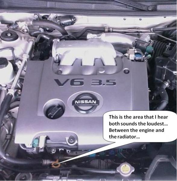

take a look at this pic...hope this helps

Well the area your pointing to you have two things there the alternator and the ac compressor. If you have a piece of tubing at home you can use that as a stethoscope just place it on the alternator or ac compressor and see if the noise is coming from either one , it could be the clutch on the compressor not disengaging. Try turning the ac on and off see if the noise gets louder or quiter.
Old Oct 5, 2009 | 01:51 PM
SuperStasiu's Avatar
Posts: 1,431
From: Chicago,Bartlett,Ill Kolno, Polska
Another thing that it might be would also be the belt tensioner pulley, try taking your belt off and turning the tensioner pulley by hand see if you get the sound from it
