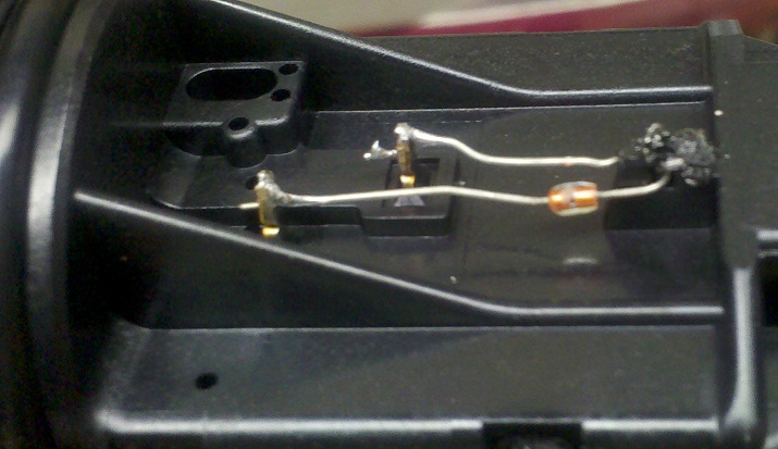

No, I did not. Question though. What part of the MAF sensor fails? It looks like it is all plastic with the exception of the thermistor.
I don't think we've ever tried to figure or even cared to figure it out. But here's this:

I guess my concern is that I'm not going to be able to get that thermistor to stay in there permanently. I know I've seen it in this thread somewhere but what seems to be the best glue/compound to use to keep it in place?
Also, the NAPA sensor has a modified TORX head that has a dimple in the middle and I can't find that screwdriver anywhere, so can't remove the sensor from the housing.
I just squoze mine in there using needle nose pliers to tighten down the small clamps that were there, no glue.

You can pick up a cheap butane soldering iron from Radioshack with some solder. Just practice on something you don't care about. All you do is wait for the tip to heat enough that solder when pressed into the tip melts, then you quickly tap on the item being soldered. The liquid solder will flow onto the parts, making a permanent connection.
I did this at work, in the parking lot in 10 minutes. No worrying about the IAT wire coming loose now.

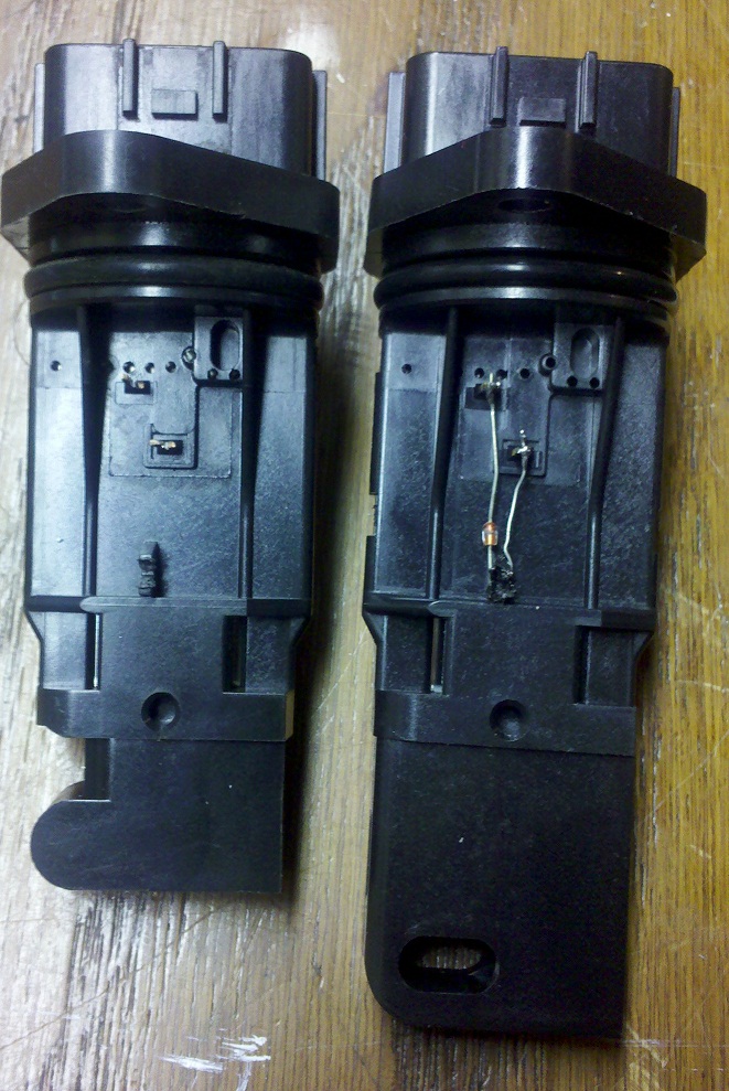

I took the sensor out of the housing for both the new remanufactured NAPA part and compared with my original OEM part. They look nearly identical to me. Both have the thermistor. Here is a closeup pic:
http://s565.photobucket.com/albums/s...okg/?start=all
The one on the left is the NAPA(2001) part. On the right is my original sensor. I cleared the codes and ran mine around the block. No problems at this point. Don't know what to make of this. The new MAF sensor ran for a week and then the check engine light was back on. Does anyone have any suggestions as to why the check engine light would have come back on? Thanks.

Anyone have a comment? It looks to me like NAPA is selling a 2001 MAF sensor that is identical to a 2002? Hasn't everyone said in past posts that the 2001 MAF does not have the thermistor? Thanks for any input..

No it wont help because the ECU is looking for a thermistor, but it should still run fine without one.
If you're like me and live in an area where your emissions don't bug you, I'd buy on from DAVEB whenver I saw fit, and then sell the current NAPA MAF (even though that sucks they wont accept the return) to a 00-01 owner and buy the correct MAF from DaveB.
If you still have your old sensor, then you can transplant the IAT into the one from DAVEB, remember to order the 00-01 version from DAVEB.
Also, someone on here found the correct thermistor for like 0.30$. It has to be in one of these MAF threads somewhere or PM Rochester, I believe he knows the details.

Thanks again, but what I'm saying is the the NAPA '01 MAF does have the thermistor. Check out my previous post #185 where I link to photobucket and look at those two sensors if you have a minute, and tell me what you think. Thanks.

Anyways, the part I pulled out was actually a 22680-6N200. I see 6N201 referred to more often here, so this may be an even older one. In any case, I decided the chance to save $355 was worth the risk, so I ordered the 22680-2Y001 part for $87 plus shipping from courtesyparts.com. The sensors have some physical differences, but sure enough, the 5.0 gen part had a spot for the thermistor. I swapped the thermistor, squeezed the metal clips with a needle-nose pliers, dabbed some solder for a solid connection, and I used the soldering iron to melt the plastic and close the U that the thermistor sits in. It took me maybe a few minutes. This is seriously such an easy swap.
I forgot to take before pictures, but here is an after picture. On the left is the old part (6N200) with the thermistor taken out, and on the right is the new part (2Y001) with the thermistor installed:
Here is a close-up of my thermistor installation. It's as clear as I could get with my phone camera:
It's not pretty, but I'm confident that this thermistor isn't going anywhere anytime soon. I suppose I could have used glue, but I didn't want to chance something that could come loose and get sucked in through the intake. The melted and cooled plastic should basically be as if a single enclosed piece now.
As far as resetting the computer, I did have the battery disconnected while I swapped the sensors, but I don't think it was long enough to do anything, because the code from my short run into the garage with the MAF disconnected was still there. I used a code reader to erase the codes.
I started the engine, and it idled fine. I gradually revved it up, no problem. Took it for a spin and went easy on it at first; all clear. Took it on the freeway and opened it up, and the hesitation was gone! She pulled consistently all the way to redline! She's cured!
Granted, I just did it today and only drove it once, but so far no codes and she runs like brand new. I'll be sure to post back later for an update, but I think I have enough experience with 5th gens to tell that she likes the new MAF.
EDIT: It's amazing after how well it ran at first that the hesitation did come back. See my later reply for more info.
