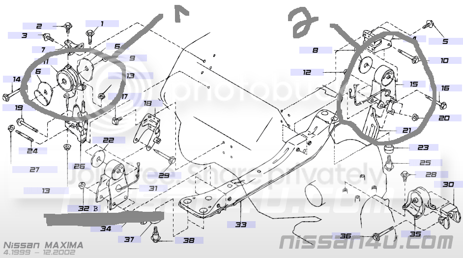

For a while had a knock in the suspension as some other members has stated too. Took my car to the mechanic and replace both front bearings and motor mounts... People no more knocking or anyhting.... The knocking noise came form the passenger side and after replacing the Top motor mount the noise is no more... so if you still have the knocking while going over bumps.. look at you top motor mount and your problem will be fixed..

When you say top motor mount are you referring to the one on the passenger side by the ps reservoir? If so I might replace this as this noise drives me crazy!

yes.. mine looked fine but it was shot. replaced and no more knocking....

The motor mount you are talking about can you post a Pic of it plz.
I have some noise come from the front and was thinking it was the front Bushings. I only hear the noise as I go over bumps nuthing at start up or reving the engine.

it is the one on the left hand side of the pic....

did you get an oem one? also any how to or tips you can give? in the diagram the front of the engine is on the bottom left correct?

it is an easy job if you have the time to do it, I didnt so I pay for the job, It was easier to watch than actually do it. I bought them OEM and no w the car is smoooooooooth as when it was new. Yes the front is is the left of the pic.
