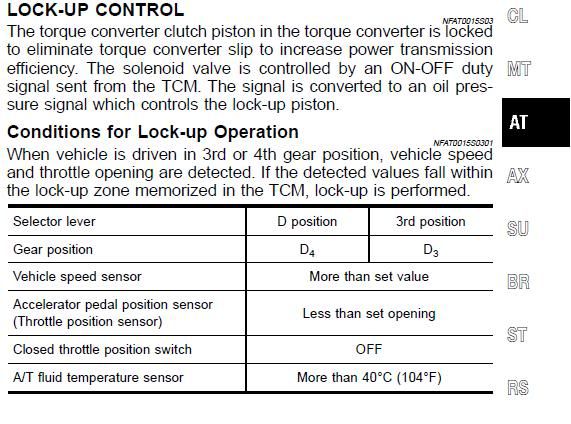

Thanks, nmexmax. Looks like my issue then is getting into D3. I get two smooth shifts then it holds for a couple of miles. I know about the torque converter lockup and that definitely takes more time.....especially in New England winters!
