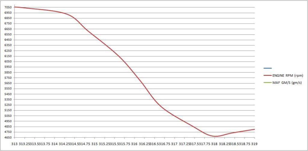

For the past nearly 2 years, I've had a vias delete (BOP) IM and UTEC extending the rev limiter to 7200. All this time, I had assumed revving out was the best way to get good times and that is exactly what I did for all my old PB runs.
Now I finally have dyno graphs of my car with the vias deleted stock IM and realize the folly in this.
6 speeds shift roughly 1500 RPMs down on each shift, so you're looking at a 1500 RPM zone when determining where you want to shift... These are both taken from the same dyno graph.
Well this is what I've been doing all this time. 5500-7k
And this is what I should have been doing. 5000-6500
As you can see, it drops off like a rock after peak... and holding out to around 6400-6500 RPMs is probably a good thing, but anything beyond that you're just moving closer and closer to that <200hp DE-K territory. ( sorry, I had to).
Moral of the story, unless you have a SSIM... don't worry about shifting at high RPMs. Shift a little over 6k and enjoy your wonderful midrange power.

I thought this was as good a place as any to post this.
Here, you can see where the 4AT shifts at after the 1st gear shift. The RPM drop quantifies the shift from 7100 RPM. Of course, the RPM is a bit higher from the 2-3. And also, just for the hay of it, it also shows how long the actual shift takes w/ a II.5 VB mod. The X units are in hertz (0.1s).

I really want to understand your graph, but the provided info is making that difficult. I assume this is meant to show Engine Speed [rpm] v. Time [ds] (Y v. X). If the units are actually 0.1*s, then, yes, it would be deciseconds [ds], which is so far from a common unit... You do not mean hertz, as that is the inverse of time (1/s), which is actually more commonly used to refer to engine speed. It is helpful to label the axes in Excel, but I don't want to complain. The info is good, thanks.
And yet another great reason to drive a 6-speed.

It's hertz, inverse of time(time^-1, or 1/time), because it is in "units" which are from my sheet, and it is in 1/60.
