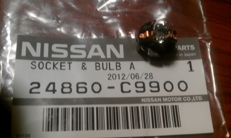

Originally Posted by Stason
It's not that they "scrape", they actually lock in place as expected, it's just that the contacts do not touch lol
Appreciate it! Let me pop by the local junkyard first and see if that 5.5 is still there. I'll let you know if otherwise. Thanks!
Yeah well the bulbs are really STUCK in there, so I tried to bush the bulb out with a really thin flat-head, which resulted in slight shift of the contacts. I didn't notice and plugged the socket with LED back in cluster, turned - it wouldn't lock, so I turned some more Mhm.. Next thing - socket breaks in pieces. Smart me.
Anyway, here is the pic. On the left - my socket, on the right - whatever dealership sold me according to my VIN.
As you can see, the bases are completely different. Mine is flat, the wrong one has a "curve". The "middle rings" are completely different as well. The locking mechanisms are different too. The contacts position is different. And to top it off, they are different in sizes ))))))
I was in the same boat. I needed the ones with the contacts on the inside. Went to the dealer and they gave me the wrong bulb. Luckily the parts guy did sone research and found me the correct bulb. Downside is that it cost twice as much...$15. But im not complaining. The the part # is 24860-C9900
Oh wow! YOU ARE THE MAN! Thank you! I'm going to the dealer on Monday and hopefully they can get this one for me! Thanks for the part number!

maxspeed96's Avatar
Posts: 845
From: Fairfax, VA

I know this thread is old but my 03 maxima is new to me so I’m 14 years behind on mods lol.
I just did this mod on my 03 SE cluster and the results are amazing.
I did manage to break two of the bulb holders so for now no lights on odometer and the other info screen.
Thank goodness for this this thread because my max has the circuit board that Nissan used for a few short months before going back to their original design so I could not find the correct bulb holders. All the ones I ordered did not fit. But now I have the correct one on its way and plan on installing this weekend.
Ive taken the cluster out so many times I can do it with my eyes closed. Lol.
Thanks to @seedyrom, @tunermaxima @maxspeed96 (thanks for finding the correct bulb holder) and everyone else who contributed to this mod.
