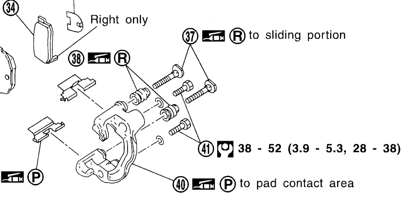

Resurrection time....pictures below
as i had my car safetied we looked for the source of the rattle, definitively brakes. the bolts are on tight, but the caliper still sits loose on the bolt unless brake pressure is applied.
How do i dampen this sound without replacing the caliper?
Is this the same rattle you guys fixed with lube?
bolt is tight, but bushing or something is loose unless braking pressure is applied
rattle comes from this part being loose on the bolt that holds it, even when bolt is correctly torqued

I had to replace the caliper mount. The part the bolts go into. Mine apparently warn and when I replaced my calipers I got the banging sound over bumps. New bolts and the mount and all is good now.

to confirm this is the part you replaced: http://www.cardone.com/Products/Prod...=141536&p=rock ?
Also...
this part: http://www.rockauto.com/catalog/more...nid=511&jpid=2
would that remove the rattle? or does that not affect it?
Is this involved: http://www.rockauto.com/catalog/more...nid=513&jpid=0 ?

Number 4 and number 1
Number 4 and number 1 is what was needed but for the rear

so what did you find was actually loose? which one was worn, 4 or 1?

Number 4 was worn but bought bolts just to have it all new
They say the above part is rear, but in the manual there is threading, what did yours look like?:
threading shown here

Those are the right bolts. They just slide in.
