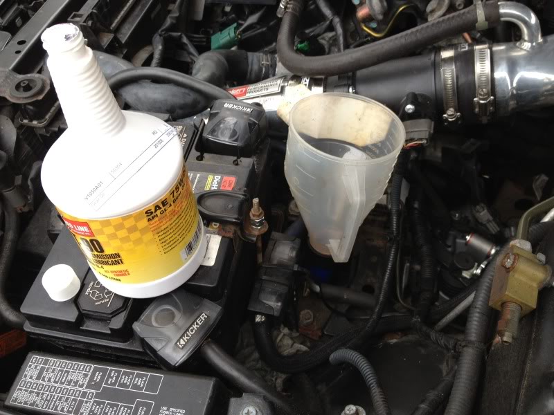

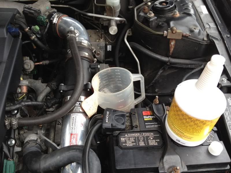

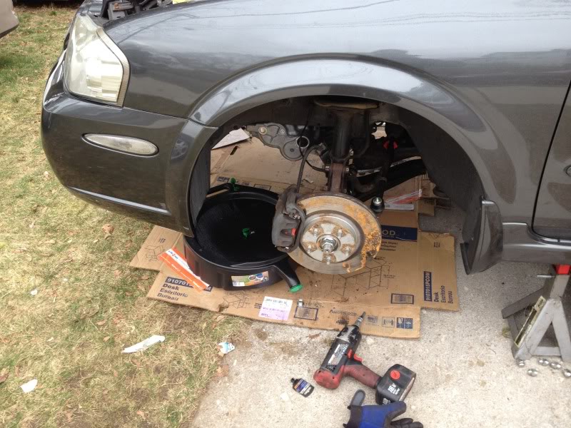

Old Mar 18, 2012 | 09:37 AM
  #47
NismoAce's Avatar
Joined: Feb 2010
Posts: 688
From: New London CT

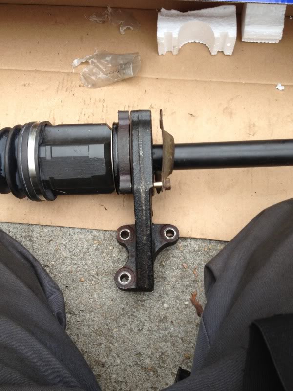

all gears feel fine now except for 5th. Its fine but Its little rough going in. This is how the other gears felt. Hope it will clear up with lubeeee.
Dont know if its the new suspension replacements or the new not used lsd but the traction is really really nice.
for reference dunno if its been posted before but, the 6th gen pass side axle bracket is diff, making the 6th gen pass axle diff as well. The 3 bolt holes that mate the axle to the bracket dont match up. But the bracket does bolt to the block the same way.
