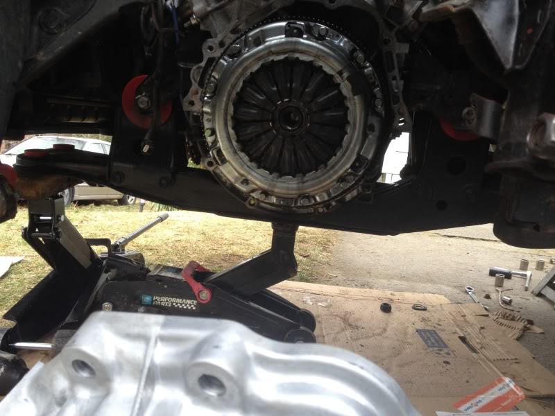

I went to start the work today and hit a coulple of snags with rusted bolts on the knuckle and control arms. The damn control arm bushing sleeve is not coming off the pivot arm. Ordered a new pivot arm. Didnt get very far today not feeling well and getting a late start.
Has anyone done a tranny removal / clutch install without removing the crossmember. It seems as I can get all the bolts off that attach the engine and tranny together. Id have to use wrenches for a few bottom bolts. But would the tranny clear the frame while pulling out? Id prefer to keep the cross member on but if it must come off it will. I just dont want to support the block and be under the car doing it solo. The only time I removed and reinstalled this tranny was with the engine and tranny out the car as a whole so it was a bit easier.
I searched on here but found nada on doing the work without removing the cross member. Thanks in advance.

I removed my crossmember when I dropped my tranny, and I was alone. If you can leave the crossmember in, it's going to be a ROYAL PITA to get the trans back up there when you're reinstalling. I would take the time to drop it. Passenger mount will help to hold it in place as well. Just make sure to put some redundancy for safety. Dropping it is the safer part. Putting it back up and stabbing it is very precarious. I had the whole car shaking. I used a couple jack stands and a length of pipe under the block to be the secondary if the jack failed. I had the foresight to get the car up pretty high initially. Keep that cell phone close.

I had the crossmember still in but unbolted when I did my clutch, it made it easier to find a place for the jack to hold the engine up with, but like said already, made it a pita to put the tranny back in. I'll pm you about the old tranny.

I removed the crossmember. It seemed like it would be difficult working around it. I was doing it on the floor though. It might be different if you'er on a lift. You should also have a transmission jack. That thing is heavy and awkwad. It's also a tight fit going back in so any extra control helps.
One tip. Remove the shifter cable bracket before you try moving the tranny. It's kind of hard to reach (gear wrench really helps) but if you don't remove it it'll bind up against the firewall when you try pulling the tranny out. It becomes harder to reach at that point too.
Also, If the new one comes with a shifter bracket use it. They updated the design to be stronger but it fits the same.
You might also have to swap one of the shifter cable connections from your old tranny so it mates with your cable. It's super easy though and you'll see what I mean.

I followed your advice on leaving the crossmember on and just unbolting it from the frame. I dont see why you would want to do it any other way. Doing it this way allows you to support it with a jack without the risk of damage.
One thing I would do diff is unbolt the downpipe from the car under the car. With my catmans on the engine was limited on how low it wanted to go. either way a jack and 4 of us was able to get it in at the worlds funkiest angle. I have no idea how anyone would do this alone without a hoist.

ok so tranny is in the car. I got the car almost done.
Keep in mind I had new control arms, wheel bearings and hubs, inner and outer tie rod, end links, and sway bar bushings going in at the same time.
All I have left on my plate today is the pass side axle, tranny fluid, both sway bar bushings and end links and im done. Cant wait.
i would have finished yesterday but I couldnt get the support bracket off the pass side axle to save my life and I had no energy left so I destined to finish it today. I woke up in the middle of the night excited as hell because I suddenly remembered that the engine I had bought about a year ago to throw in came to me with just the support bracket installed on it. No need to fiddle with the old one. So in a little I will head outside to finish the ho.
Pics coming in the following post.
I'll have to try it that way next time. Here in north Florida rust isn't an issue so everything comes right apart.
