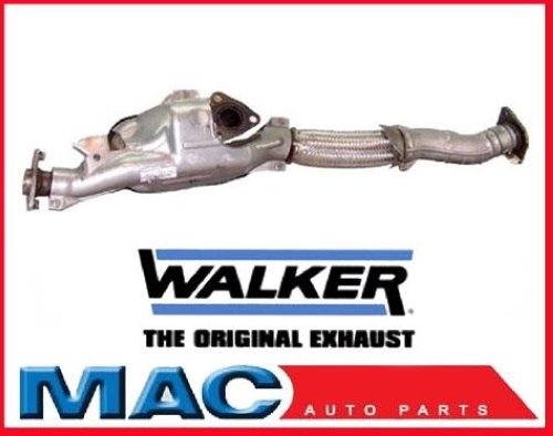

Seriously, I do not know what heat shield you guys are talking. Someone educate me please.
I like the "hitting the crossbar" theory. Check for play in the exhaust or any marks from banging.

AznRyan's Avatar
Posts: 968
From: Gulf Coast
Maybe that heat shield?--v
Old Mar 3, 2012 | 07:12 PM
AznRyan's Avatar
Posts: 968
From: Gulf Coast
Different brand, but heat shield would still look the same :P

Thank you!! Idk why I thought headers would eliminate that.
No.
Sounds like the y pipe is hitting the crossmember. If you reused the stock exhaust hanger near the cat, then heatshields shouldn't to be your issue. Jack the car up and and see whats what.
OBX headers....

I was wondering how long it was going to take for somebody to put 2 and 2 together. Why are people showing pics of a stock y pipe when he said he had OBX headers?
