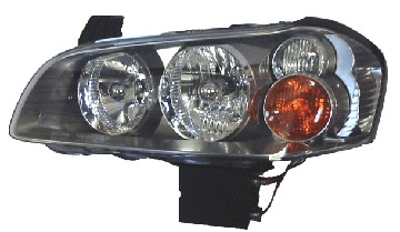

Which one of these does your headlight look like?
or
The first headlight is for 2000 & 2001 Maximas, but a few people have installed them on their 2002 & 2003 Max's back when HIDs were being stolen off their car.
Old Apr 1, 2012 | 08:00 AM
archie6214's Avatar
Joined: Mar 2012
The bottom pic is the one I have on my car.
