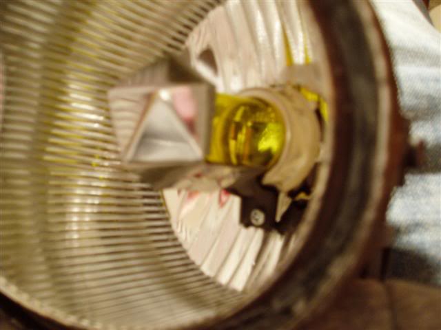

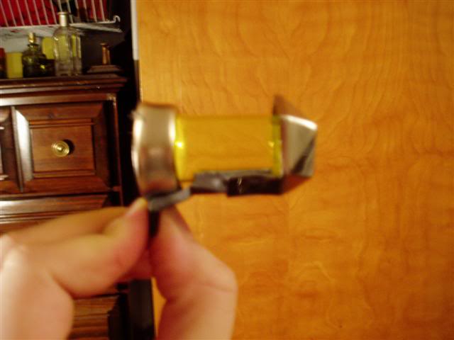

This is what installing a capsule is like
Keep in mind if you don't do it perfect the first time you are going to have to open your fogs again until it is perfect. Here's how mine used to be setup.Name:  fog007.jpg
I had one of the capsules come loose and fall out. at that point I stopped using my fogs.

Ok thank you haha.. It's the process very very hard or did you just mess up ? Maybe a bad capsule

It depends on what you planning to use for as bulbs. When I first did lexus capsules in my fogs I used 9005 capsules which worked great for clearing some of the H3 HID bulbs out there...however for a 5.5 gen foglamp, it will bump up against the lens and I couldn't use the glare shields. At one point when reassembling the lamp, I cracked one of the capsules...and over time, that capsule shattered.
2nd time around I found H3 style capsules that people used for early 90's Acura integra's. The mounting was completely different and required me to do a bit of modification to the lamp. After it was done, I was having issues with clearance of the bulb. Still running this now, but it works.
Moral of the story is not all capsules are created equal and be prepared to do some modification to make it work.
