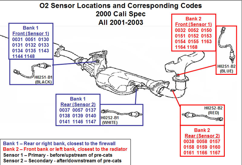

There is a diagram on this site I added below that should help. I replaced just the upstream rear and it was Bosch part #13350.
