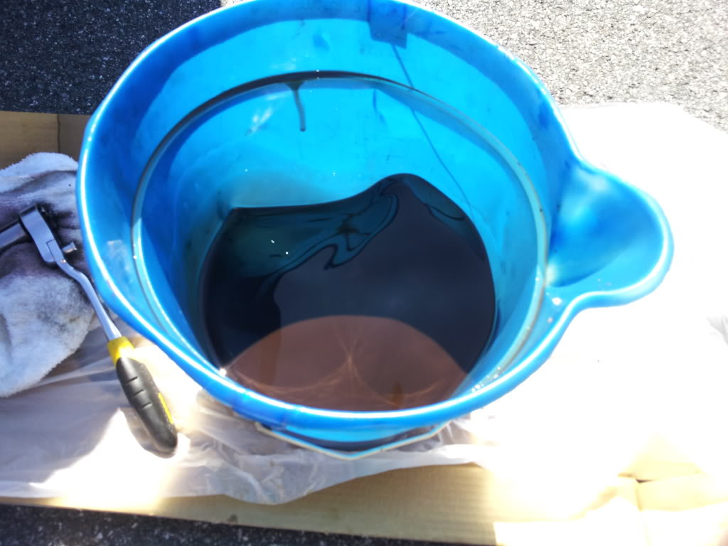

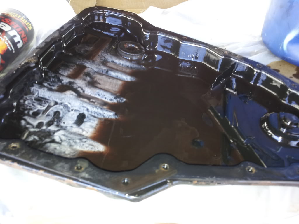

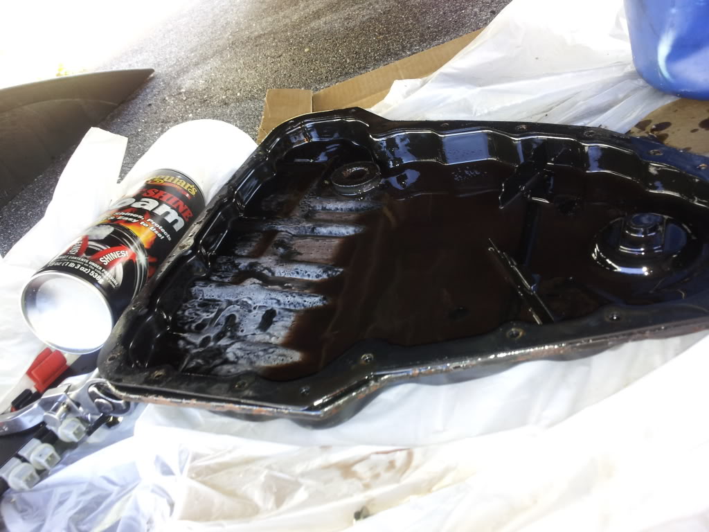

i got a used transmission installed and let me say i am not happy. My car was slipping like crazy when i was driving in the city and i smelled something burning. I went home looked at the dip stick and it was reddish brown. I then decided to drop the pan and the fluid was brown and smelled. I am still under warranty and the place i brought the transmission is willing to give me another one and the shop that installed my transmission is willing to put another one for free. I am so mad at myself cause i got f'ed over. I have a very good feeling that they did not change the fluid at all. I should of checked the dip stick before i left the place. Right now i am waiting for my sister to pick me up a transmission filter. Do you guys think that when i put the new filter and fluid in the car will drive fine or do you think that this transmission will go bad sooner or later. My main reason to change my old transmission is because i had water damage. thanks

Old Sep 15, 2012 | 03:49 PM
anhhuy8's Avatar
Posts: 460
What is that that white stuff on the pan. And no I did not spray tire shine in the pan. Thanks
