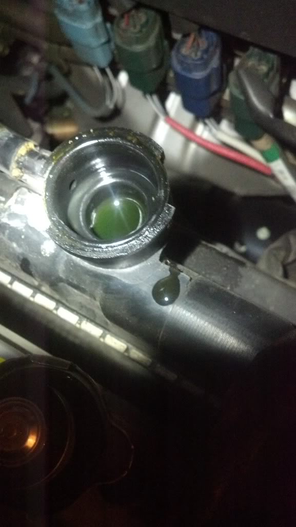

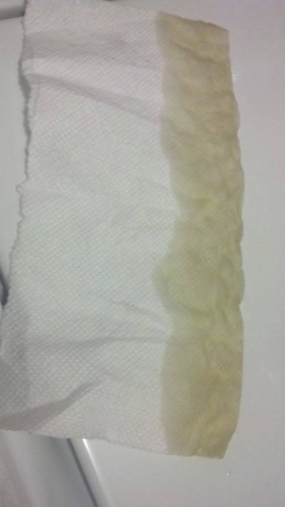

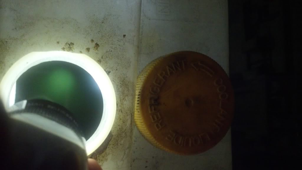

Okay just took this pictures, the coolant looks like what you guys have been saying that it should look like that for that age, I made a comparison with her moms Altima which I just flushed about two months ago and filled with prestone 50/50.

Comparison between Maxima(dark color) and Altima (clear).

hey ghost, can you get a pic of the radiator cap view of the Maxima that might have the leak? The overflow reservoir could still be pretty green even if the radiator was full of oil.

Hmm, doesn't look quite brown enough to be the amount of oil that you explained you have lost. I could be wrong though.

No CaTalyst.X it fell from cap when I removed it.

Ohh im sorry I read the post wrong, both of those pictures are of the maxima coolant.
That coolant doesn't have any oil in it. Thats a totally normal amount of brown. Id say the engine is burning the oil.
Here is what I recommend.
1: Flush the coolant according to what Toxic! said.
2: Change the oil (seems like you just did that)
3: Check the oil every morning and note how long it takes for the oil to show MIN on the dipstick. Note how many miles that is, and report back.

Originally Posted by Toxic!
Also, wouldn't oil in the radiator/coolant cause the engine to run hotter? How does the temp look in your car after normal / daily driving?
If there was a qt of oil in the coolant, then yeah for sure. If nothing else, it would gum up the water pump/radiator and it wouldnt flow right.
There is no way there is Engine Oil Capacity - (the 1/2 qt the OP got out of the pan) = roughly 3.5 qts in the coolant.
ghost: Your coolant/oil is not mixing. The coolant system capacity is only about 8qts, there is no way it mixed in that much oil, especially with how clean your coolant was. That engine is burning alot of oil.
However, if you went 5-6K without changing the oil, that is not SUPER uncommon, as some maxima.org members add about 1qt per 1000 miles. I think you just have an oil burning VQ35DE on your hands my friend.
Old Sep 30, 2012 | 10:13 PM
ghost's Avatar
Joined: Jul 2003
Posts: 48
From: Los Angeles, ca.
I told her to take her car to work tomorrow, will monitor oil when she gets to work and when she comes home, will do flush either during the week or next saturday and report back.
Oh yeah I checked the temperature when I drove it and it's normal, now I'm thinking it's the oil burning issue, btw it's been a little over 3k since last oil changed and changed from dealer oil (she used do oil changes there) to mobil 1 full synthetic at home.
