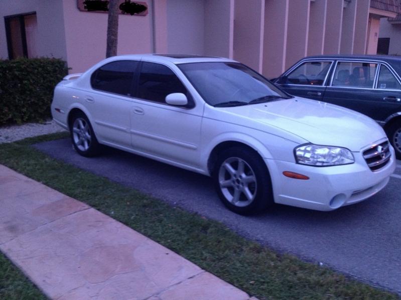

Just bought a 03 Maxima SE at a fairly good price ($2,700).
I owned a 1986 Porsche 944 turbo so all i knew were European cars.There are some issues with the car but not so bad .
Here's what i found and done so far.
1. Transmission - The Fluid hasn't been changed for awhile when i did my initial check the fluid was dirty so i have it flushed and replace now the car changes gears alot better.
2. Oil change, spark plugs, air filter, fuel system - i had all those changed and, i thought the fuel pump was going bad or something because the fuel gauge would fluctuate, so i did a 3 step fuel system clean from tire plus and now the gauge is working fine.
now here are the other things that i found out but not sure how to go at it.
the car sounds rough when i start it, i went to get the car diagnosed because of the check engine light and they told me that the Cat Back may have went bad. Also the suspension on the car feel horrible, whenever i go over a bump it really hits hard and you can feel the bumps really bad. I did a couple search on line for the suspension system and found a few but im not sure which to go with (open for suggestions).
Well so far those are the things ive found out ill post more as soon as i do, one more thing would i need to change the PCV valve?. Also if theres anything else i should change or look for please let me know....
