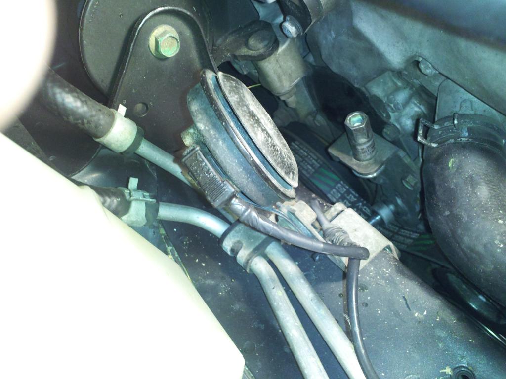

Also, another question i saw....Right in front of the idler tensioner mounted on top of the frame rail is about a 2" plastic disk thing with a vacuum line to it, what is this ? I noticed the PO kinked over and taped the vac line.

this is a horn

LOL, it looks kind of like a horn, but its not that. It has a vacuum line to it.

lol take a picture of it

This thing !

That is a horn, specifically the one for the security system. It's supposed to be mounted on a bracket. Instead of wrapping the wires in tape, nissan put them in a tube which makes you think it is a vacuum line.

Thanks, I cant believe its a horn LOL ! and why did the PO kink and tape the wires then.....strange....It was late and cold last night when I was looking at it though.

LMAO....ya, what a wierd place for a horn, whod'a thunk it !
