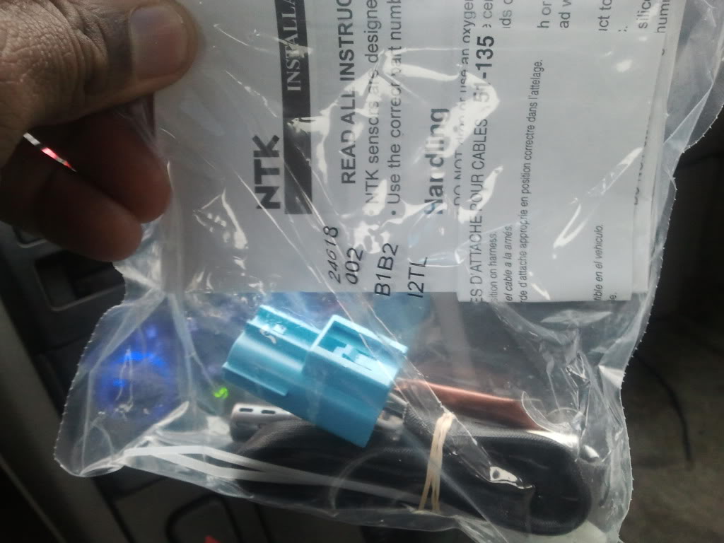

http://s276.beta.photobucket.com/use...ca4c4.jpg.html
I hope this is the right o2 sensor

The **** did you buy an O2 sensor for?

From: deptford, nj
I have the P0420 code so im going to see if its an o2 sensor.
Old Mar 9, 2013 | 06:41 PM
chrome91's Avatar
Posts: 7,623
From: Edmonton, Alberta
i believe P0420 is usually a O2 sensor problem no? a few cars at work (not Maxima) have come in with it and a new O2 sensor fixed it

Apparently my catalytic convertor is done and the hose that leads to my oil cooler is rotted out and leaking.

I cant do anything about my pre cat to expensive right now. I was told my coolant leak is from a hose going into the oil filter im guessing he meant the oil cooler, do I need to drain the coolant out to replace these hoses I discovered there are 2 hoses one on either side of the oil cooler.
