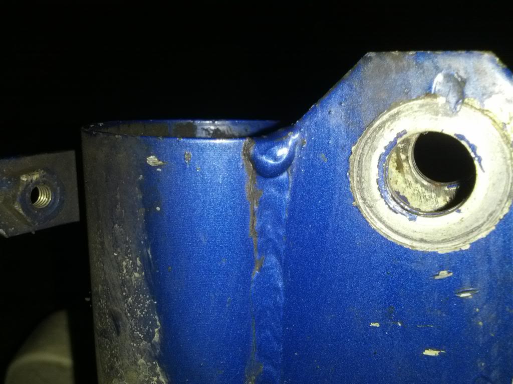

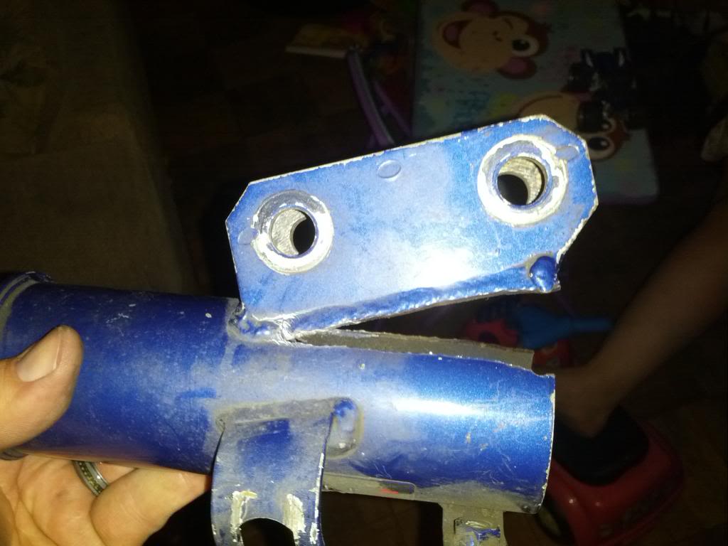

The failed lower CO mount:

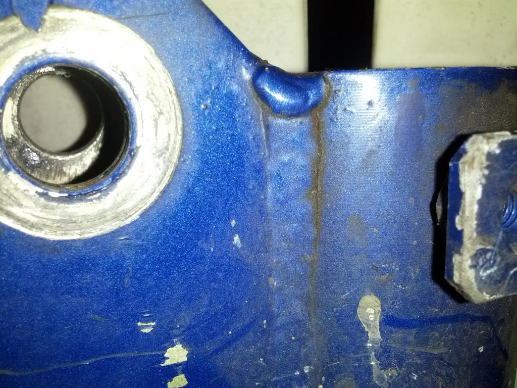

I thought it was due to that one hard hit, apparently the tube was already failing. Here's the other side:
Given those cracks these were already on their way to failing catastrophically. So I guess I was really lucky.
Sad part is I have maybe 15,000 miles on these. They sat in my garage for most of the time I had them.

Wow that a pretty bad crack is there any type of warranty with those like there is with some coilovers? since it looks like a bad factory weld where it stress cracked.

This is the second JIC that I seen all JACKED UP!!! The first one when I was in MD visiting and a member had one on his 5th gen. It was a blown front strut on the JICs, now I see this garbage. They asking too much money for them dam things for this to be happening!!! Thats why I passed on them! Expensive trash!!

This could happen with any strut made by anyone, it doesnt mean JIC is crap. OP, you failed to mention at what speed you took this RR track.....
Old Apr 23, 2013 | 08:13 PM
Froggmann's Avatar
Joined: Jun 2007
Posts: 1,887
From: Vacaville, Ca
35-40 under the 45 MPH limit. All it did was finalize the crack and start the failure. It also doesn't explain the crack on the other side that was 75% to the threaded collar.

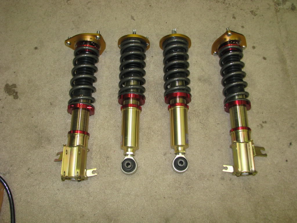

I wonder if JIC knew about this problem, because if you look at my JIC coilovers, that bracket is part of a reinforced sleeve that goes all the way around the tube, whereas your bracket is welded directly to the tube.

Thats some quality welding/steel...
