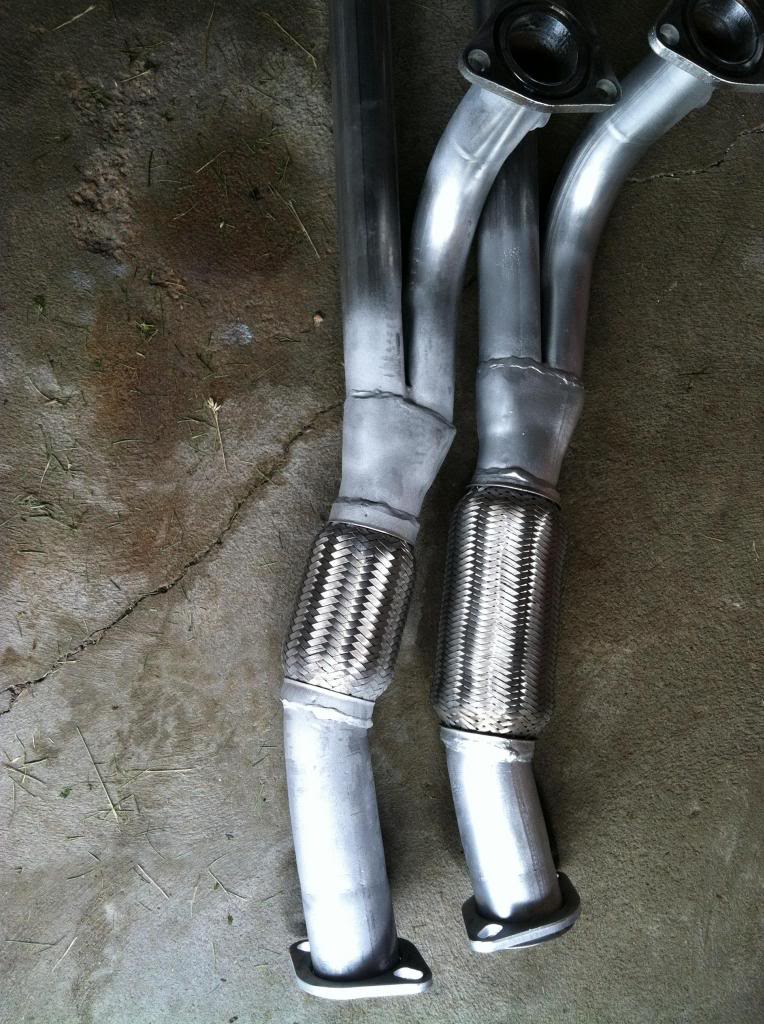

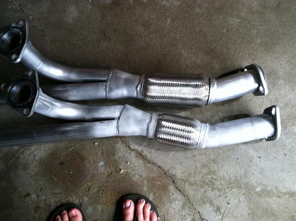

I've got a quick question for members with the warpspeed y-pipe.
I've got friend who bought 2 Warp speed y-pipes 1 for him and the other for his wifes car. Both are 2000 fed spec.
When he got the y-pipes the flex pipe was different on both of them.
I wondered if anyone has dealt with this and if one is better then the other.
Mine have the smaller flex pipe section but one of them he ordered has a big flexpipe section.
I wondering if this is a really old model of it or maybe a new design.
Guessing it wont make much difference but the one with the bigger flex pipe is really flexible compared to the shorter one.
Here are the pics.
Also it might be hard to tell but there both the exact same length y-pipe and weld look good on both just one flex pipe is about 4 inches longer and bigger diameter on the outside. Inside diameter is still 2.5"
On a very odd side note that is dirt on my toe nails lol i was working on digging a hole for a small pond when he came over lol.

I've heard none are created equally but DAMMMM Lol I'm willing to bet one doesn't line up as nice as the other too.
I'd put one with longer flex pipe on my and other on my wifes jus cuz mine would see lot move abuse and long flex pipe would give more flex with motor movment.

Yeah i told him to bring both to the shop and which ever one fit better just use that one and then i can weld / fix the other if there is any issues.
It's really hard to tell with out bolt it up to the car but it does seems they might be and different length from the front pipe to the collector but just hard to see with them side by side since the longer flex pipe makes it look like a optical illusion lol.

This is common. Even Cattman started using different flex pipes back when.
Pic on the bottom looks as if extra pipe was added on to fit.

My Y-pipe has the short flex section. I had alignment problems with the muffler hanger and wonder if the longer flex section would have eliminated the problem.

last pic, look at the bottom where it mounts to the cat. Looks to me like the orientation is off...
The longer flex one looks proper, the other looks like it's off by about 60* or so. They are both on the ground at the same angle so they should both look the same where they mount to the cat. (unless that fitting is supposed to be loose)

Yeah, flanges do look off, but WSP has a tendency to use non-fixed flanges, rotatable. At least they used to on their test pipes.

Yep your correct the end flange is rotatable so i just didnt have then lined up the same when i took the pic.
I'm going to install the one with the bigger/longer flex pipe first since i think it being alittle more flexible will make it easier to install then the one like mine with the small flexpipe but find out on saturday.

I still have an original Cattman flex and as I recall it is shorter like the one on the left in the bottom-most picture. If your engine mounts are worn then the flew will get more wear than it should. Mine are worn and it is holding up anyways lol

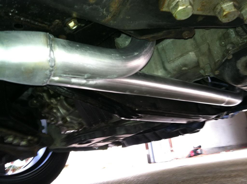

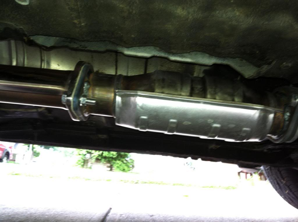

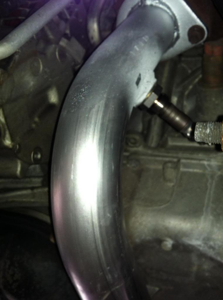

Well installed the Warpspeed Y-pipe with the longer flex pipe, Magnaflow cat and SRS RE exhaust.
Took about 3 hours to replace it all.
Luckly i was replacing everything since other then the y-pipe nuts the rest of the bolts and nuts on the exhaust were too rust to even try to take off since they just fell apart lol. So i just used a tail pipe cutter and cut the exhaust at 3 places and removed it all.

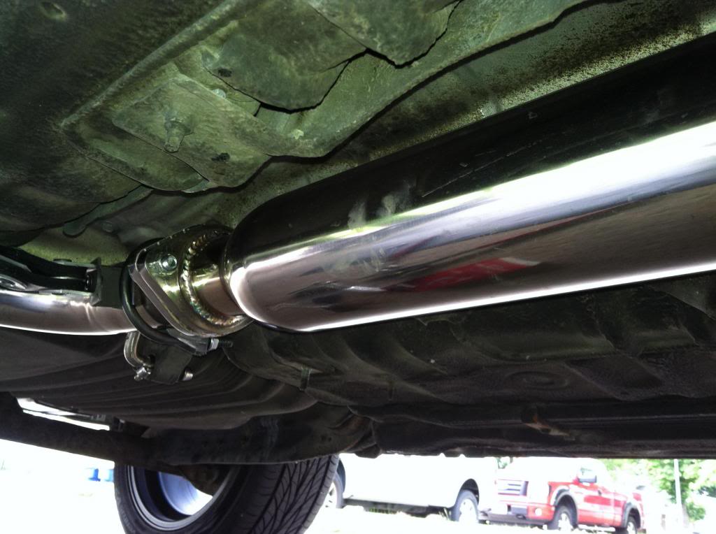

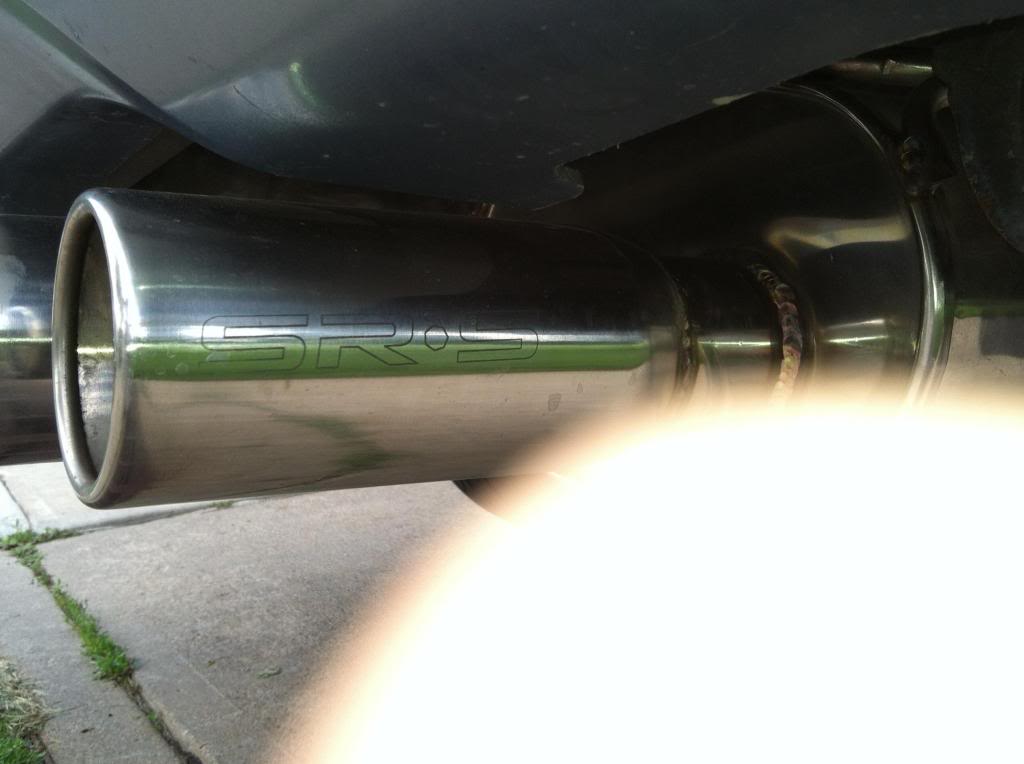

I would have install everything in less time but i think the SRS exhaust was welded wrong or something since the pipe that bends over the rear axle was touching the body on the top causing vibration and rattling.
to solve that i went and bought longer rubber muffler hangers there just like factory but are about 3/4 longer and brought the muffler down a little to bring the pipe down so it doesnt touch now.
On the plus side the Warpspeed pipe fit like a dream so that was nice.
Good luck. I hope you don't have the problems that I had.
Luckly it all went on perfectly.
The rear gasket that came with the warpseed didn't seem to fit right for me i just didnt like the way it look. So i just grabbed a standard 2.5" 2 bolt exhaust gasket and installed it instead and it sealed up nicley and the gasket help center the pipe so no leaks.
Also taking the car back in tomorrow on the lift to second check all the nuts and bolts tightness now that i drove all over the place today and allowed it to heat and cool a few times.

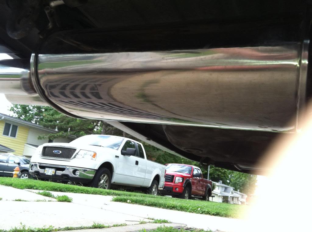

As promised here are the pics of the installed warpspeed Y-pipe , Magnaflow high flow cat (ordered with warpspeed pipe) and SRS dual tip exhaust.
You will also notice the pick of the middle rear hangar where the SRS exhaust bends i installed a second hangar since it seemed to move side to side more then i wanted it too causing the exhaust to bang on big bumps.
Doing this made the exhaust tight as a drum and solved the problem perfectly also after putting it on the lift today and having some one rev it up and checked for leaks all is perfect i've put around 175 miles on it since the install 2 days ago.

only thing i noticed is that you put the rusted nuts back on instead of replacing them?? i bought new ones so i don't have to worry about them rusting back into place.
