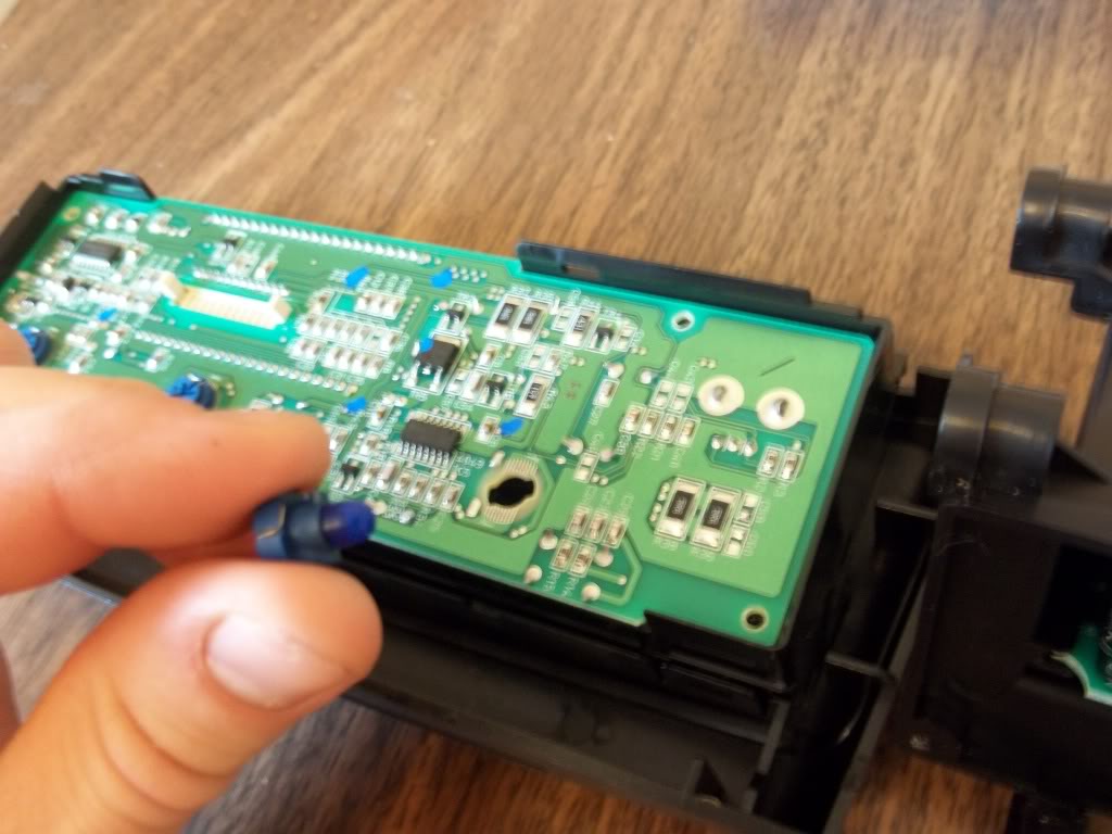

Well coincidentally the same 2 of 3 bulbs are out again. Now IIRC someone actually found the underlying reason for these bulbs shortening out, and did something to the board to fix the cause of the issue in other words they didn't just replace the bulbs but they did something to correct the problem while changing the bulbs. Does anyone have any ideas, or insight on why the same bulbs would go out a year later?
So while searching for links to add above, I found this and I think this is what I was remembering.
http://forums.maxima.org/5th-generat...e-control.html
Originally Posted by Shinjiduo
Believe it or not but one of the things I learned a out the HVAC controls using LEDs is that the polarity is reversed on the bulb behind the "AUTO" button. So the ground is on top and the hot lead is on the bottom. This might account for why only two go out. This would imply a physical issue with the circuit board not getting a good contact with the bulbs. You might want to paint the bulb bases with plasti dip in order to create a tighter fit with the circuit board. I know that is what I did to get a better fit with aftermarket T4 bases. (Which I feel fit very loose in the HVAC without help)
I am going to try the plastidip method and see if that works. I am confused though because if you plastidip the bulb bases, how will the connection be made?
I will post results once I get around to it. (obviously takes time to see how long it works)

OEM bulbs aren't LEDs so replacing them with OEM bulb should last more than 2 years. My OEM bulbs are going on 4 years with no issue.

yeah i kinda figured that out after I read over his posts, doh!
i replaced them with oem straight from nissan, and within a year the same 2 locations went out on me....
