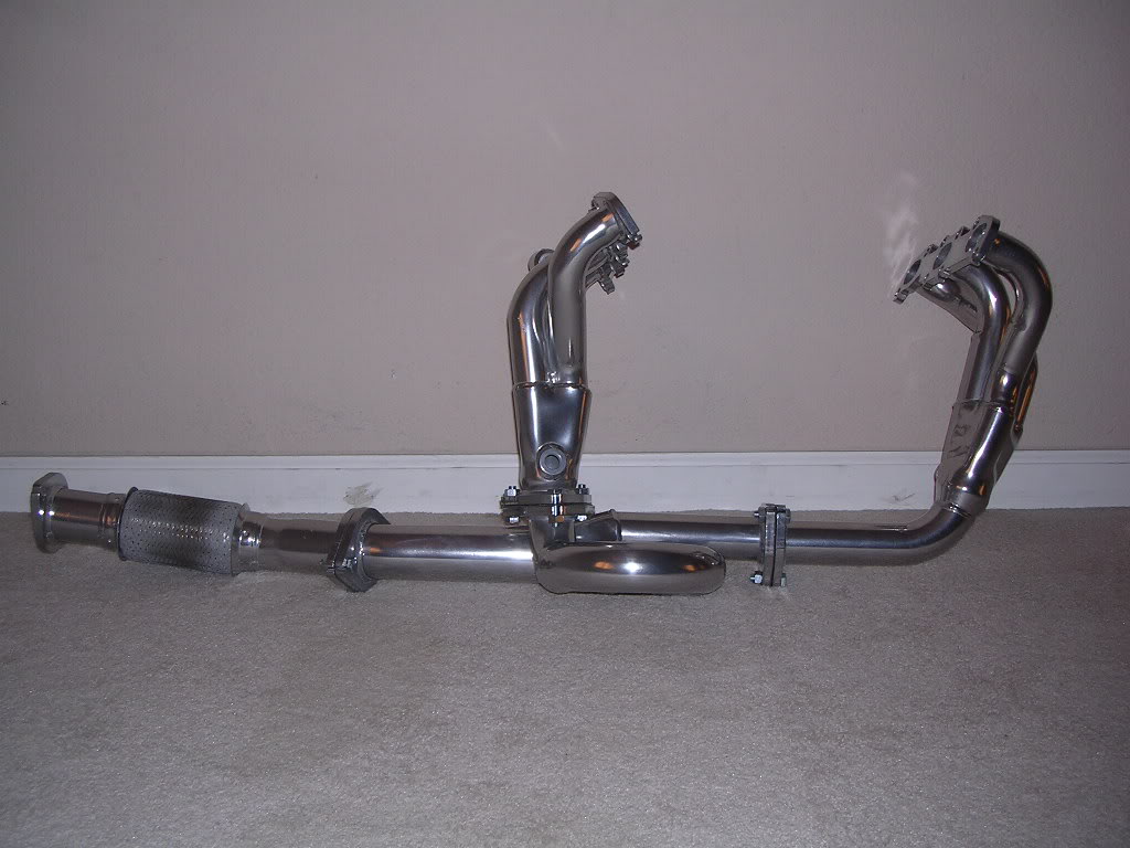

Originally Posted by NmexMAX
I wonder if the Gen I Cattman headers are slightly different design since I have yet to (never say never!) get oil on the exhaust during an oil change, and never has been an issue for me to even think about.
I thoight first gen Y's were unequal length, so the "loop" that hugs the oil drain plug in the new versions don't exist. Though, I thought I read where you had second gen headers/Y!?
Old Sep 10, 2013 | 09:51 AM
NmexMAX's Avatar
dot dot dot ...
Posts: 34,576
From: Santa Fe, NM
I've got first gen units. The original 3 piece design.

your loop is more round, the newer ones are oblong. I was just under the car i should have taken a photo
