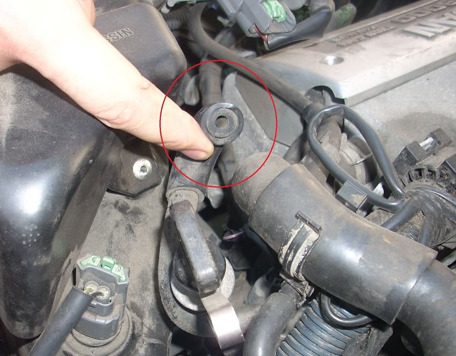

So the vacuum line from regulator goes in to a split, one side to manifold the other one of mine is unplugged, it's vaccuuming but idk where it goes, might've come off during starter replacement, it's s shaped, does anyone know where it goes?

Send a picture of what you see -- there is one line that sort of goes nowhere, and you would have stumbled on it during a starter replacement... check this out:
Is that what you're seeing? I believe it is an automatic transmission breather.
(I lifted this pic from somewhere else in the forum, it's not mine)

That one I plugged to black box on intake, there's one that come from the top to about the same location

http://carphotos.cardomain.com/ride_..._large.jpg?v=1
If you can see this link there's two hoses on top of intake manifold it hat come together for a bit, it's the smaller one to the left

Was I not supposed to put this into the intake box thing, cause that would explain where my loose hose goes.

I've done some research but it doesn't answer my question, the breather hose is not plugged in to anything, just sits there?

Correct. The breather hose allows the system to "breathe." As components heat up, the fluid (in this case, ATF) will expand a bit and needs someplace to go. If not for a breather, leaks would be likely.

So the nipple on the intake is most likely for my vacuum hose that I couldn't find a location for, cool. Thank you
