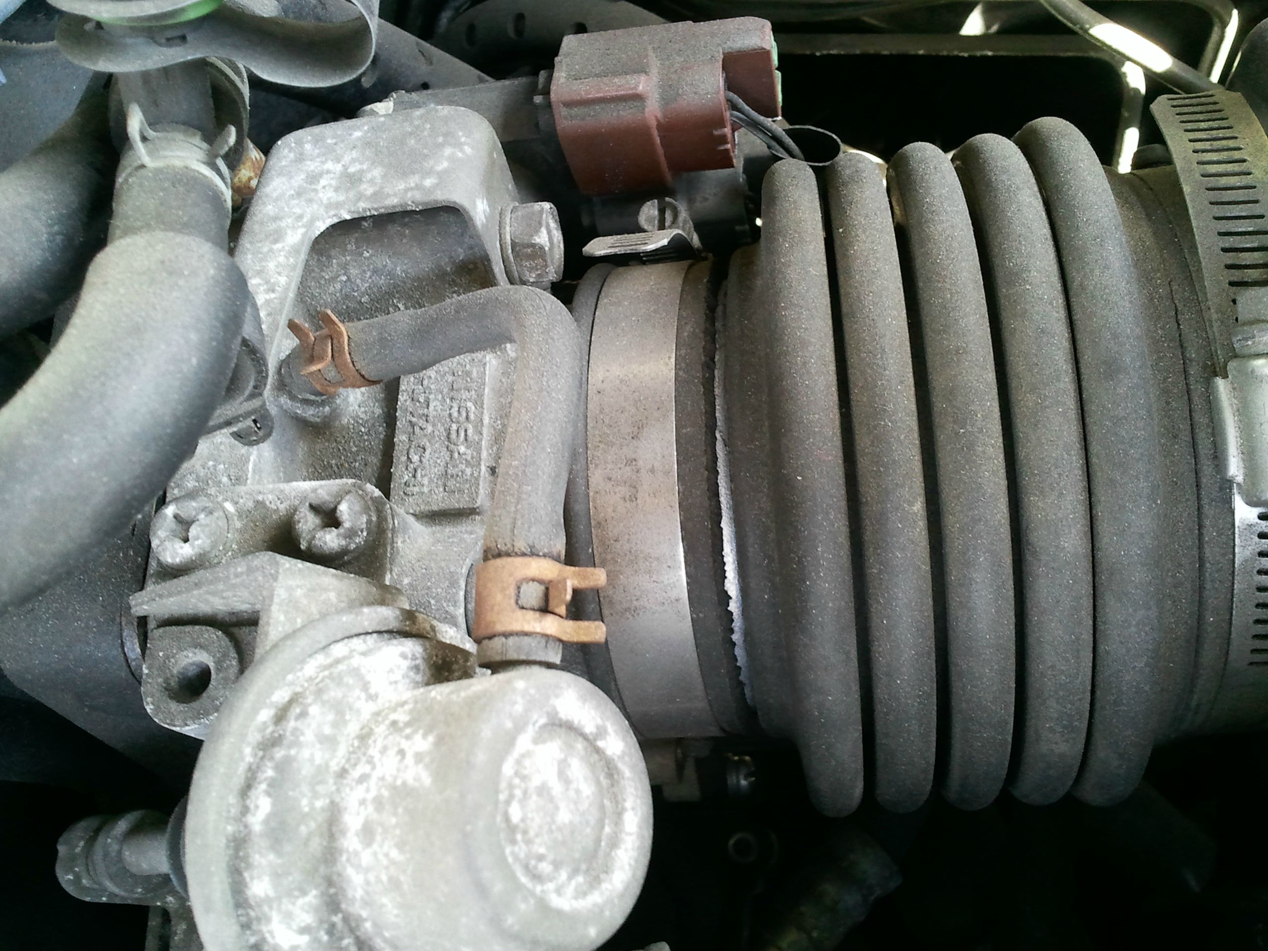

could this rip be the cause?

It is a possibility because it could be letting air in after the MAF sensor. You should replace that sleeve anyway, but if you could somehow temporarily seal that crack, you would have your answer.
BTW, that small vacuum house on the dashpot is cracking around the hose clamp. You may very well have more vacuum hoses that are becoming brittle and cracking. You should consider buying a couple of feet of vacuum hose and replacing hoses.
I don't know if I can temporarily seal it. The rip seems to be almost all the way around.
Is replacing the sleeve just a matter of undoing those 2 clamps and sliding in a new one? or do I have to remove the resonator and air cleaner assembly before that?

I can't remember if the sleeve will compress enough to allow you to replace it without removing the resonator stuff. I lean towards thinking that you can, but I wouldn't stake my life on that. But it isn't that difficult to remove the resonator and air box. The hardest part is getting the MAF wire harness connector unplugged.

[QUOTE=DennisMik;8933542]I can't remember if the sleeve will compress enough to allow you to replace it without removing the resonator stuff. "I lean towards thinking that you can"
Si se puede or yes you can if you replace it with a new one or one thats not stiff and brittle: )
