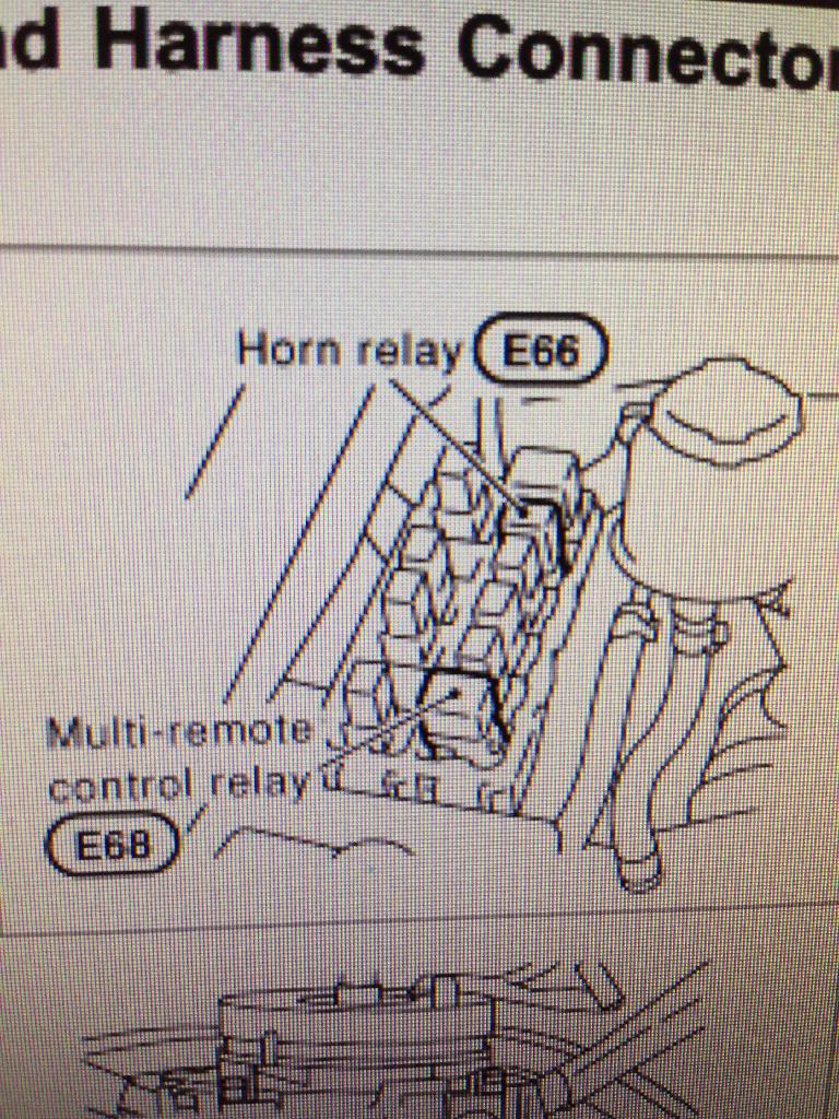

In this thread, the guy said to open this pdf document and check page EL247 for the Multi-Remote Control System.
I went to page EL247 and found this picture:

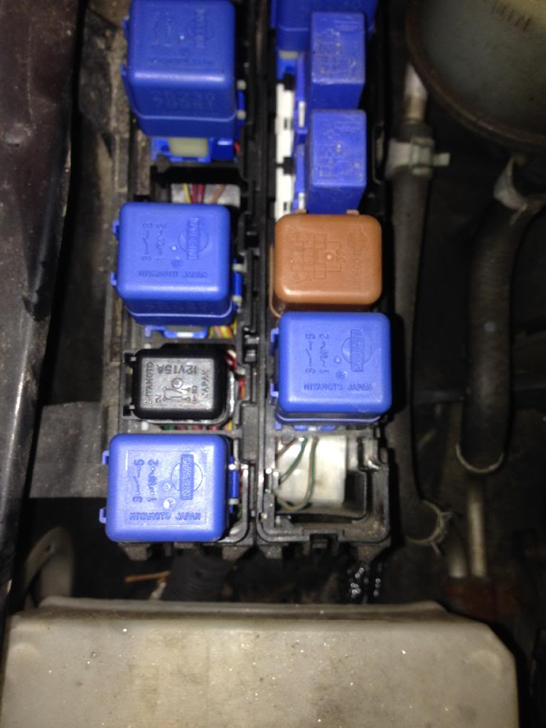

So I popped my hood, took of the fuse cover, and found this:

So the multi-remote control system fuse doesn't exist on my car?
I GUESS the purpose of this thread is, is my car capable of having a keyless entry remote, and if so, how the heck can I get it to work.

In that link on nicoclub, what you are looking at is an error in the service manual. If you go to page 340 in that same link, you will see a different drawing for that relay bank. Page 340 is correct. I don't know what car the drawing on page 247 is for. It is not the 4th gen Maxima, either.
