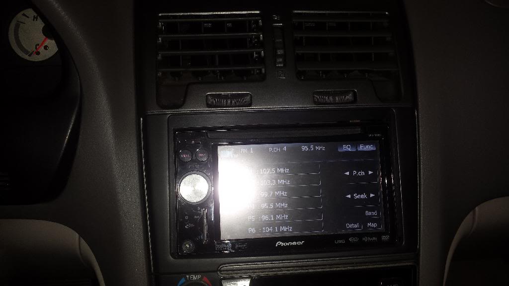

I replaced my bose head unit with the Pioneer Avic F900BT a few years ago. You would need to buy the GXE center ventilator assembly for it to fit. Really easy install. You can essentially get whatever double DIN radio you like. I've seen some people with units where the screen pops out, but I like double DIN because it looks very clean and seamless.

I installed a pioneer head unit only problem I had was for some reason my tweeters hardly put out in noise and the door speakers don't seem to be nearly as loud as before anyone had this problem
Old May 7, 2014 | 01:33 AM
dfj240's Avatar
Joined: Apr 2012
Posts: 676
From: TX/LA
Did you wire the speakers directly to the new unit or did you use a line adapter? If you wired them directly they won't project as much sound because they are being driven by the head unit instead of the proprietary amp for the Bose system.
