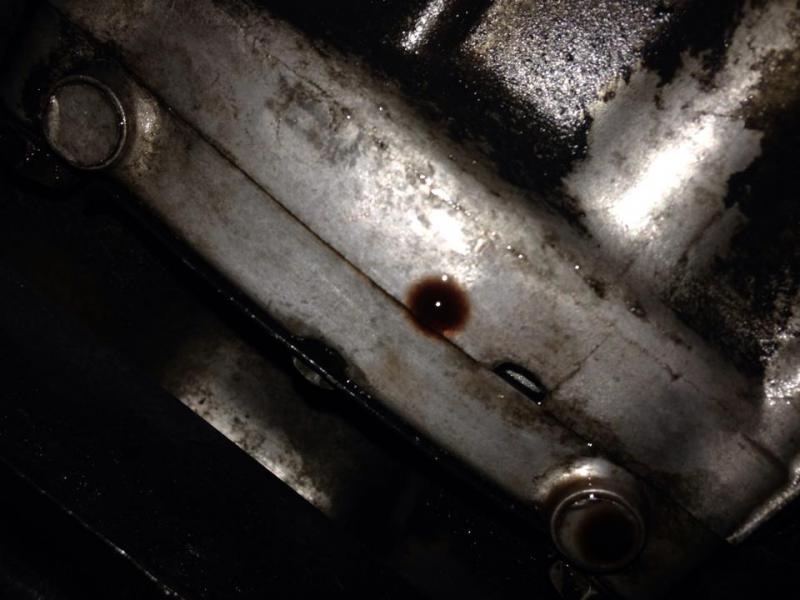

This is the hole im talking about. To the right of the drip. The drips from where it was leaking and running that far before it dripped.

Old Apr 15, 2014 | 08:15 PM
chrome91's Avatar
Posts: 7,621
From: Edmonton, Alberta
no idea off the top of my head if that hole is even supposed to be there and if so why. what side of the trans is that hole on? bellhousing or tail?
Old Apr 15, 2014 | 08:22 PM
nismo_nut's Avatar
Joined: Apr 2014
Posts: 7
Im not forsure Ill jack it up an get another look tomorrow I just reached my phone underneath to snap the pic then zoomed in.
