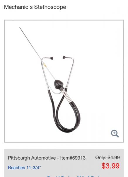

Best $4 I've ever spent when dealing with my cars (Harbor Freight), and especially rattles. There are host of causes for your rattle. Try eliminating some. Does it rattle only when a/c is on / oil level good / accessory mounts eg alternator-are they loose / belts tight? If it's internal maybe cam followers or lifters.
I wonder if theres a Harbor freight near Phx Az.. ill find out and buy this
